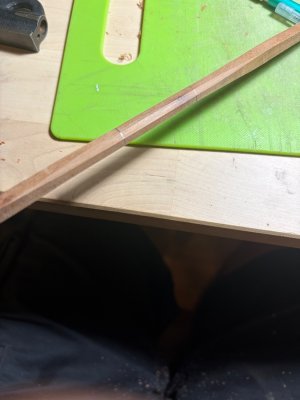

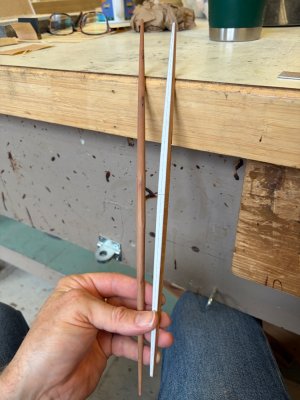

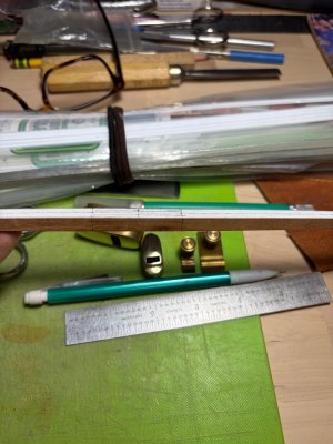

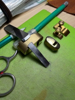

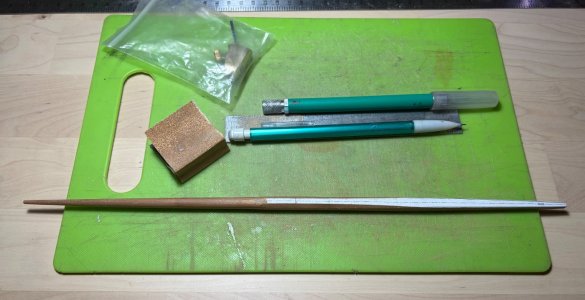

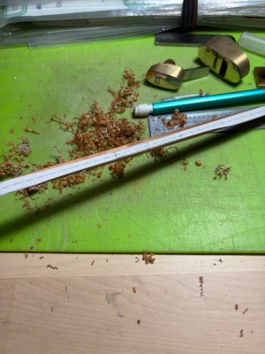

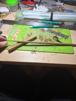

So, next I decided I would take the more traditional approach of bandsawing in two planes, and then using finger planes to micro-bevel into the round:
I had found some nice quarter-sawn cherry laying around, and cherry’s natural color has the added advantage, for this application, of appearing to be coated with some kind of preservative pine-tar. This, IMO, is more realistic than the brightness of maple, for example.
I’ve only gotten so far as profiling in one plane, before I was sent out of the shop for a few days. I will be interested to see how my little finger planes perform after a good tune-up.

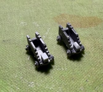

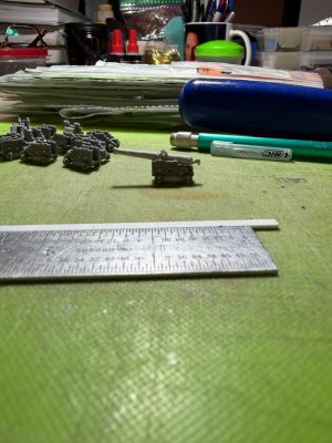

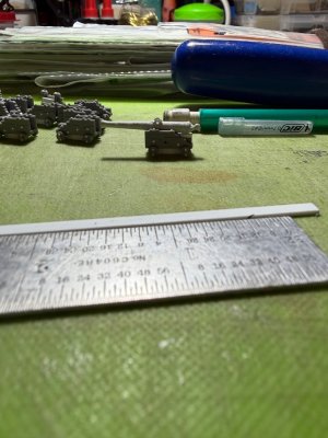

So, in addition to that project, I have drilled for the f’ocsle bitts and painted the f’ocsle deck. While I was careful to mask for the galley chimney bases, and the belfry knees, I neglected to mask for the gun carriage mounts. That’s okay, though, I can trace their footings and scrape paint as I did for the bitts:
I’m also making a bunch of eye-bolts for the gun-carriage rigging. Basically, almost everything I need to assemble the f’ocsle deck is ready and waiting.
