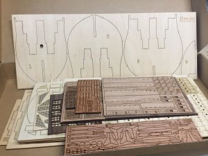

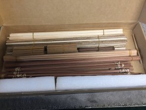

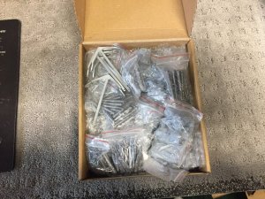

Welcome to my first time attempting a build log. I ordered the kit from ZHL and it arrived in 8 days to the US.

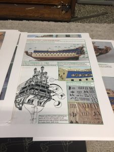

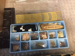

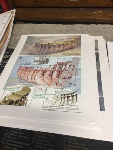

The kit was well packaged for shipping and arrived in good condition. The kit looks to be very well made and the building materials are excellent. The English instructions are good and plans will be more than enough to get it built.
Thanks for looking.

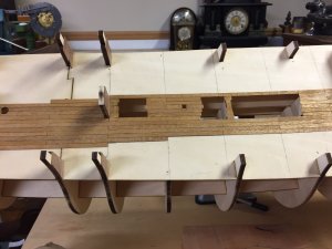

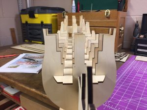

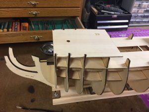

Well I finally started the Soleil build, and boy did it feel good to be in the shop after a crazy summer.

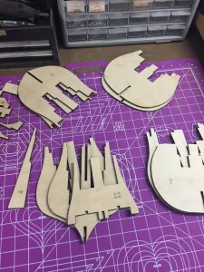

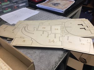

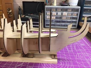

I got got the keel glued together and bulk heads cut out.

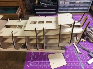

Dry fit the bulk heads and lower deck. With a little sanding they all fit well.

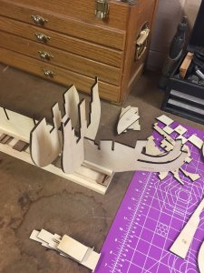

I did have a problem with the number 1 bulk head, it delaminated down one side. I glued it back together and clamped it up, should fix it right back up.
I think I'm going to enjoy this kit.

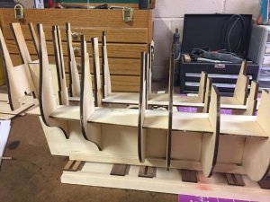

Another thing. If the bulkheads are dry fitted and are in a perfect place. You can use Chair Doctor Pro glue and run in onto your dry mounted bulkheads. It very strong and easy to use.
