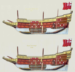

Here is a picture showing how the internal decks were rearranged. This had an effect of the decks no longer lining up nicely with the side gallery decks and windows, even though the side gallery design went essentially unchanged. I imagine that after 1660, you would have to step down a few steps as you enter the side gallery and then walk forward down the sloped deck of the gallery to go outside. Note that the top end of the rudder is located too high, and the tiller should be located just below the middle gun deck, not above it, as was typical in 17th century ships. See the cross sections above for the location of the tiller relative to the lion head mounted above it, and how the tiller was relocated a bit lower after 1660.

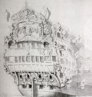

Stern gallery after 1660 as drawn by Willem van de Velde:
