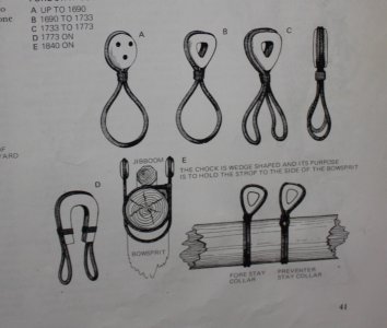

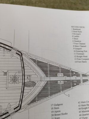

Here's a few places you might look:Not sure what to do about the bowsprit position! out of the box build or modify, can't find a whole lot about modifying the kit. I bought myself a book hope it helps![]()
I'm interested in the problems you had ? care to share?I will be interested to see how you solve some of the difficulties I had.

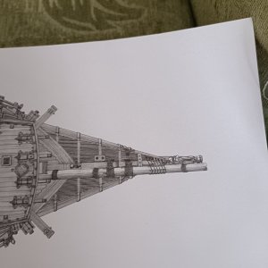

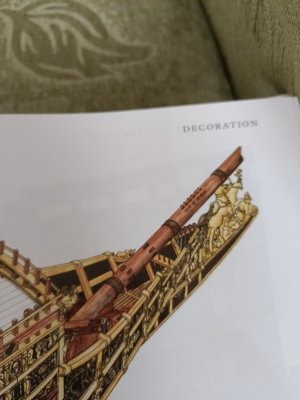

I will also follow along - PS: I did some detailings with bowsprit - The kit really misses here IMO.Not sure what to do about the bowsprit position! out of the box build or modify, can't find a whole lot about modifying the kit. I bought myself a book hope it helps

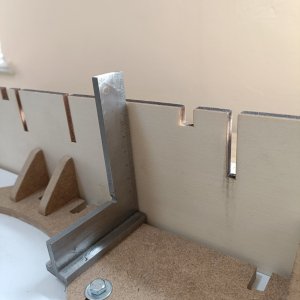

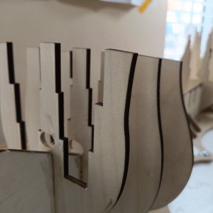

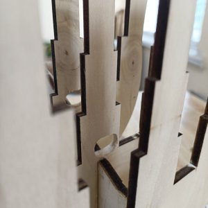

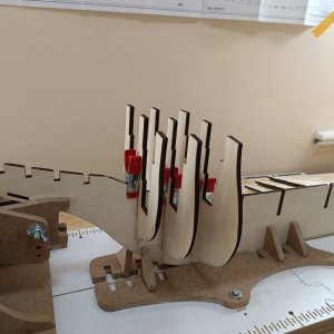

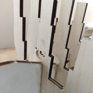

Couldn't resist making a start
View attachment 613795View attachment 613796View attachment 613797

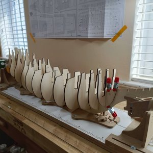

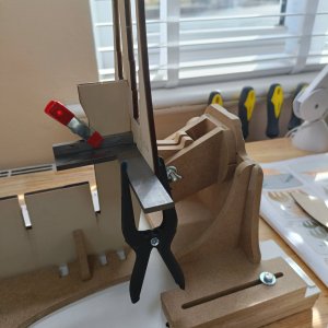

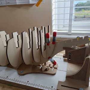

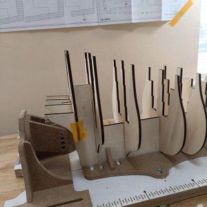

???PS; Big YES on your blocks and ropesAfternoon guys, just finished getting the model room ready for the SoS this will be another long build diary hope you can pull up a chair.
View attachment 613783View attachment 613784View attachment 613785View attachment 613786View attachment 613787View attachment 613788View attachment 613789View attachment 613790View attachment 613791View attachment 613792
Hi Brian,Afternoon guys, just finished getting the model room ready for the SoS this will be another long build diary hope you can pull up a chair.
Never mind, found it!Following along! Now tell me more about that framing jig! Is that custom or commercially available?
Yep mine is in the front row Brian. Another monster build to gleefully watch. Cheers Granthope you can pull up a chair.
I take a humble backbenchYep mine is in the front row Brian. Another monster build to gleefully watch. Cheers Grant
