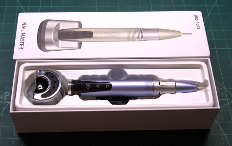

Let’s start with the Nail Master JMD-109S by JimDOA. What first drew me to it was the slick, modern design—it just looked well thought out and clean. But what really impressed me once I got it in hand was the charging base, which turned out to be magnetic. That was a pleasant surprise and a welcome one at that. Anyone who's used rotary tools knows the struggle of trying to keep them from rolling off the bench like they've got a mind of their own. The magnetic stand, which also doubles as the charging base, keeps the tool upright and securely in place. It’s a simple feature, but incredibly practical for a hobbyist's workspace. The charging stand also has a handy feature—a set of holes to hold up to 6 bits. While 6 might not be a huge number, it’s a nice touch that helps keep your essential bits organized and within easy reach. It’s small conveniences like this that make a difference in a well-designed tool.
The packaging of the Nail Master JMD-109S also deserves a mention. It reminded me of unboxing an iPhone—solid, hard cardboard with a premium feel to it. Inside, the tool is nestled securely in a molded plastic tray, which keeps everything in place and protects it from any potential bumps or damage during shipping. It’s clear that a lot of thought went into the packaging, ensuring the tool arrives in perfect condition and giving you that “premium” unboxing experience right from the start.

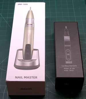

Size matter! One thing I didn’t quite expect was the size of the tool. From the images, I had pictured it being a bit smaller, but it does come across as a little bulkier in person. Of course, that’s purely on me for not checking the size chart beforehand. It’s still manageable, but if you’re expecting something ultra-compact, it might feel a bit more substantial than anticipated.

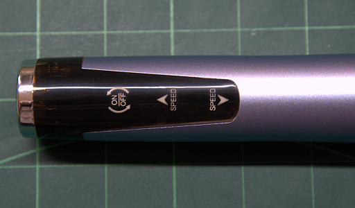

While the slightly larger size than expected was manageable, the real disappointment came with the touch-button operation controls. I can’t tell you how many times the speed accidentally increased or decreased on its own due to the slightest touch of my hand. It’s incredibly frustrating because when you’re focused on your work, the last thing you want is for the tool to suddenly start spinning faster or, worse, slow down just when you need it. The lack of tactile feedback and the sensitivity of the buttons make it difficult to hold the tool properly without unintended adjustments to the speed.
To start the tool, you have to press and hold the ON/OFF button. It always powers on at speed 00, which means you then have to tap the arrows on the screen to set your desired speed. Here’s the kicker—when you stop to change the bit and restart the tool, it resets to speed 00 again. Seriously? It’s such a basic design flaw, and it can be really frustrating when you’re in the middle of a task, only to have to reset the speed every time you power it back on.
Another annoying issue is that lightly touching the ON/OFF switch can change the rotating direction. The problem is, you don’t need to stop the tool to switch directions, so you might be working on something, focused, and then boom—the tool starts spinning in the opposite direction. It’s not only frustrating but can also be risky, especially when working on delicate details or near your fingers. One wrong touch, and you could end up damaging the work or even yourself.
So, is there anything good about this tool? Yes, definitely! While the touch controls aren’t ideal for me, the tool itself is solid in many other areas. It features a 2.35 mm collet chuck with a precise mechanism, making it great for holding bits securely. The tool is surprisingly quiet for its power and offers a decent amount of torque. I used a 0.5 mm drill bit at various speeds, and I got excellent results—smooth, consistent drilling without any wobble. Plus, it has an auto power-off feature, which is a nice touch—it helps preserve battery life by shutting down automatically after a period of inactivity. As for battery life, I haven’t had the chance to run it for hours on end, but after using it for about an hour, I noticed it dropped just one bar on the battery indicator (out of four). It’s clear that the engineering and build quality are top-notch, even if the controls leave something to be desired.

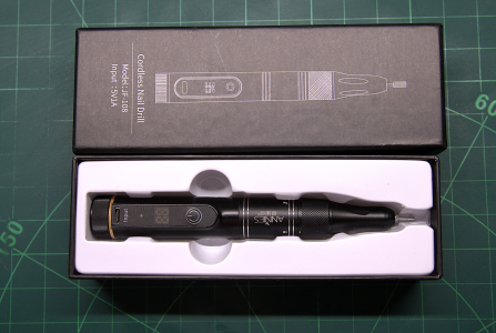

Annie’s JF-108 offers an appealing blend of functionality, design, and affordability. It has a clean and sleek design that immediately stands out. Its compact size and modern look make it feel like a stylish addition to your workspace. The packaging is sturdy and well-organized, with the drill and accessories safely stored in molded plastic to prevent any damage during shipping. It’s not as flashy ;) as JMD-109S but it definitely feels like a tool that knows its purpose—simple and effective.
Unlike the JMD-109S, the JF-108 is noticeably smaller and shorter, with a sturdy aluminum alloy body that feels solid and well-balanced in the hand. That compact size plays a big role during long sessions—where the longer, bulkier JMD can start to feel like you’re wrangling a hoer, the JF-108 stays nimble and easy to handle. It’s less tiring on the hand, especially when you're deep into detail work and already leaning over your bench like a shipwright with a deadline.

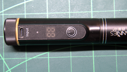

This tool features a straightforward control system that’s easy to get the hang of—even for beginners. No touch buttons here! Just press the ON/OFF switch, and the tool starts spinning right away. Speed is adjusted using a dial, giving you smooth and precise control from low to high. Need to reverse the rotation? Just press the dial, and you’re good to go. The digital display shows both the speed and the direction, so you always know exactly what’s going on.
When it’s time to change the bit, you’ll need to stop the tool by pressing the ON/OFF switch—but here’s the good news: when you power it back on, it picks up right where you left off, keeping your last speed setting. No more resetting your dial every time you pause. It also features an automatic shutdown function to help preserve the life of a high-performance battery, which is a nice bonus when you forget to turn it off mid-project (hey, we’ve all been there). It seems that 2.35mm is the standard shaft size for most nail bits—and conveniently, it’s the same for many jewelry tools too. Both the JMD-109S and the JF-108 use collet systems with clasp-locking mechanisms located inside the body. In my experience, this setup does the job just fine—the bits stay firmly in place, with no wobble or slip during use.
Charging the JF-108 is straightforward. It uses a USB-C connection (cable included) which is always a plus in my book—no hunting for some weird proprietary cable. The charging port is located on the side of the handpiece (the first time seen such a setup), but takes about 40 minutes for a full charge compared to 20 minutes for JMD-109S.
As for battery life, while I haven’t pushed it to the absolute limit, it’s holding up impressively so far. I’ve used it for a few sessions—around an hour each—and the battery barely budged. It seems to sip power rather than guzzle it, which is great if you're planning longer hobby sessions without being tethered to a charger. Until I do a full drain test, I’d say the battery life feels solid for its size and purpose.

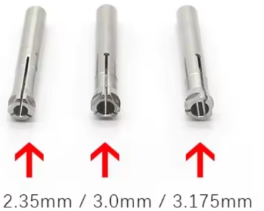

Just out of curiosity, will these nail drills handle the same shaft sizes as are used by Dremel tools? I bought a Coslus nail drill which works off of a USB power supply (It is not cordless). The body is much smaller but it can not handle the shafts of Dremel size bits. The machine is wonderful for sanding and shaping and seems to have as much torque as you demonstrated on your video. It is priced at $9.99 and come with 6 different heads and a sanding drum head with a lot of different grit sanding drums. Here is the buying information

Hi, Rob.
Good question! No, neither JF108 nor JMD109S nail drills don’t take the same shaft size as standard Dremel bits—Dremel uses a 1/8" (3.175mm) shank, while mine both tools are designed for the smaller 3/32" (2.35mm) bits typical of nail drills. So unfortunately, Dremel bits won’t fit.
However, I know, and @Steef66 can probably confirm, that some nail drill handpieces can be fitted with collet chucks that accept 3.00mm and even 3.175mm shafts. I’m fairly certain that spare chucks are available for both of my machines as a replacement if one wears out, but I’m not sure if they make chucks specifically sized for additional shaft diameters, like the 3.0mm and 3.175mm used by Dremel.
Here is the link so you get an idea
