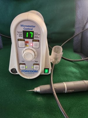

  • 1 Foredom Micromotor - this is my go-to tool. Great torque for a self-contained hand set. Even though corded, the cord is supple to the point I don't realize it is corded. Ergonomically, it is a 10/10 and shines with small carving tasks.
I do understand the Foredom Micromotor is not for everyone, as it is expensive, but honestly, if it had been my first "rotary purchase", the. other purchases would have been made.

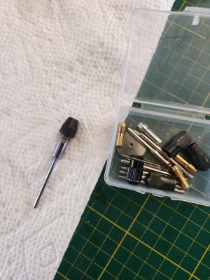

Yes, I've got this covered. Perhaps I should have said, "tool AND adapter hoarder". ROTF
On another note, which I completely forgot to mention when comparing the two models, the collet chuck on the JMD is noticeably shorter than the one on the JF-108. While that might not seem like a big deal to some, I believe that the deeper a bit sits in the chuck, the less chance there is for deviation. That said, to be honest, I haven’t observed any noticeable deviation with either of the rotary tools I've reviewed.
I throw them away, because they wobble and you can't use that with rotary carving. Change the chuck for bigger bits like 3 or 3,175 mm. See my topic of carving. If you want something else use for that job the Dremel.
I’m with you on that, bro, I think you’re right. That said, I’ve recently discovered that among all these 'nail drills,' there’s a surprisingly wide variety of chuck types—some shorter, some longer, and with different diameters. It can be quite a challenge to find exactly the one you need, especially when it’s unclear whether a specific collet chuck can even be replaced.:rolleyes:
I use adapters only when I need to drill parts with a drill bit less than 0.4mm in diameter. I couldn't find ones on the standard 2.35mm shank.
Steph, I said I hoarded tools and adapters. I never said I used them all. ROTF I've actually never used that adapter, and if I am honest with myself, I can never see a situation where I would use it. Why did I buy them? Well, as I said in the earlier post, I had not yet bought my Foredom Micromotor.

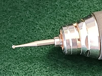

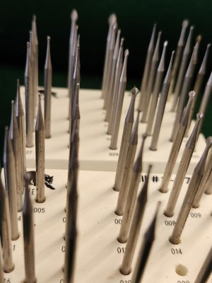

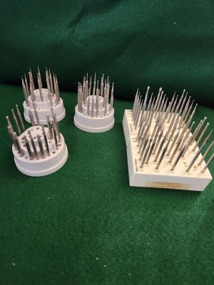

I do a lot of carving and use micro chisels and the Foredom for all of it.
Now, if you are OCD like me, you'll notice the carving burs in the rectangular cases are not sorted by size. That is because on my way to set them up for this photo, I dropped both of them and just reinserted, in no particular order. Thanks Steph!! ROTF Now I have to spend the next 30 minutes putting them in the correct order.
