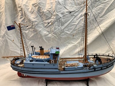

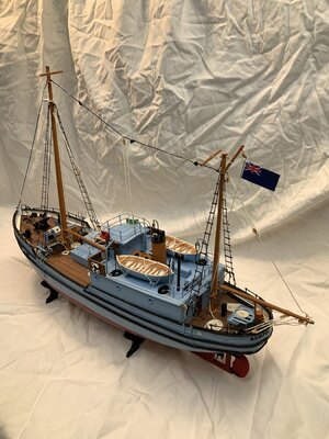

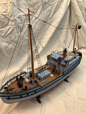

St. Roch Bruce Ives
Beautiful and good photography as well.

Hi Bruce:
I think your photos above are the best colour guide and I will use them. The photo on the front of the kit box shows the boat being white. The instructions I have offers a short colour guide on page 5 and my page 25 shows some of the large wooden parts with the boat parts outlined. I'm about to venture into the fine art of planking. Stay warm although it's quite amazing that the first real cold snap of the winter didn't happen until early February and should only last a couple of days.
Hi Alex
It looks like Billings has changed the box and the instructions since I built the St Roch.
I used the pics on the link below to choose my colours. And I bought all my paints at Lens Mills. Ironically on Monday my wife and I drive to Ottawa and early Tuesday we leave for Iqaluit where it is currently -35 with wind chill -53.
