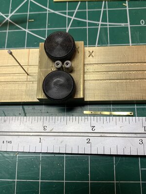

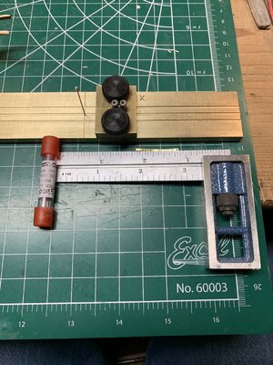

After receiving a lot of good recommendations and techniques I adapted one clamping jig with space stopper pin and put my own evolution of that which a local machine shop owner, apprenticed in Austria with a degree in mechanical engineer and metallurgy, produce for me from my drawing and the chunk of hard brass that I took in. He said he would have to anneal it to settle it down before proceeding further and then recommended acquisition of bushings to better guide the drill. COVID and Wx delays set the production schedule back almost a month but he called this morning saying he had the bushings and we discussed his commencement of the new "toy" for this boy. The photos make it pretty well self explanatory.
The center guide groove is for my 1/64" x 1/16" brass strips for the shroud chain plates for my BN MS2130. Drilling with a #28 bit is through the first bushing and then a stopping pin feels out and drops into the hole in the second bushing with the spacing that I needed. With prior experimentation and frustrations I decided to bite the cost bullet and proDrilling JIg for small brass strips.jpgceed.
There are less expensive ways that many SoS members use but with my eyesight and other challenges I was not able to consistently receive the results that I wanted . . . at least for these parts of the schooner . . thinking "it doesn't cost, it pays".Drilling Jig Closeup.jpg
The center guide groove is for my 1/64" x 1/16" brass strips for the shroud chain plates for my BN MS2130. Drilling with a #28 bit is through the first bushing and then a stopping pin feels out and drops into the hole in the second bushing with the spacing that I needed. With prior experimentation and frustrations I decided to bite the cost bullet and proView attachment 214010ceed.
There are less expensive ways that many SoS members use but with my eyesight and other challenges I was not able to consistently receive the results that I wanted . . . at least for these parts of the schooner . . thinking "it doesn't cost, it pays".View attachment 214011

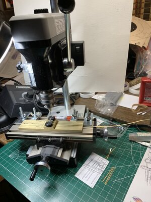

Your drawing and idea to move the stock and not the table gets the credit. I used it today to drill out all of the shroud plates and now need to do some filing and shaping to accept the deadeye strops on the rail top. I can now also drill and shape some items for the bowsprit area rigging. I will still need to deal with drilling holes for the various bands on the yards with single, double, triple, and quad rigging connections. I'll probably to do a much thinner sheet stock which I can cut, fold and drill than staying with the 1/64th for a lot of that. Thanks again for your idea. It is working very well with my small drill press and the jig on the table with the bushings using a regular #68 bitt.
Rich
Rich

I initially tried to drill freehand through the jig bit broke two bits not having sufficient feed control. When I put the jig onto my small drill press, moved from the cold garage into the warm den work area I have had no breakage of bits and as long as I secure the feed stock with the finger screws I get the perfect alignment that the bushings provide. It will work for some fittings and not others depending upon folding through drilling complexity in a case by case basis.Small brass drilling jig at work.jpgView attachment 214262

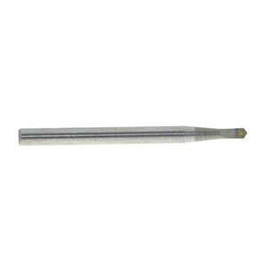

Some days ago I ordered from Fischer Goldschmiedebedarf so called "Spitzbohrer" "HM-SPEAR DRILL" of the company Meisinger
I guess these are following the same principles
