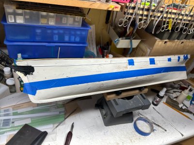

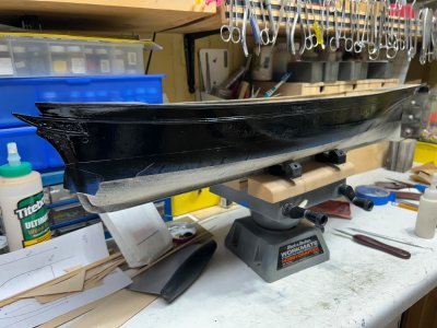

Thanks Peter. I'd work all night long, but mama needs me. Once the monkey rail is installed, I’ll paint the hull black and copper it.

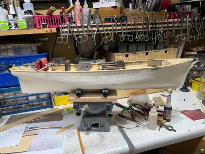

I looked back at your build and you did use ample amounts of putty. But you were adding inner bulkhead spacers. That takes a lot of work to get right and contoured. You too did a wonderful job. However, I’m not laying a single plank deck, as you did. I’m doing the pre-cut scribed type. I learned where to cut corners and not diminish the detail or look. My mantra!
Thanks again for the fine comments
Rob

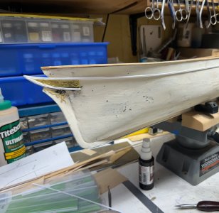

The forecastle and poop decks are level with the main rail...once I add the scribed decking. I will then add the 18" monkey rail with its cap. I think when all is dry within...I will begin shaping and carving the molding on the planksheer. It has a kind of carved out center....creating two lobes of the planksheer. This same trim look will be carved on the monkey rail cap as well. (The stern rail around the stern stanchions will also be carved) (at a later date). It's these little details that set the build apart. I need to address these issues before I paint the hull black. As I look at it now....there are so many small details that need to occur at the same time...or there abouts.
Rob

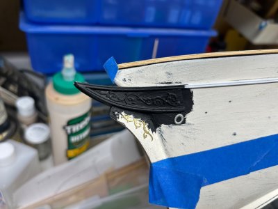

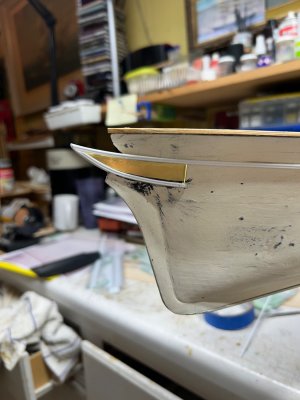

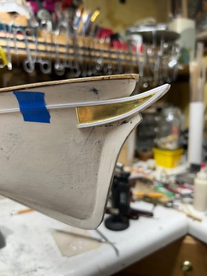

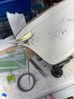

Today's projected work schedule will include addition of the McKay *Hoods*....port and starboard. Once they are fabricated and installed, the addition of the leading planksheer moldings will be installed atop the leading edge of the *hood*. All the external moldings have to be installed prior to painting. Since the scroll work is unspecified, I can assume artistic license, in this matter. I prefer to get the external paint out of the way, prior to deck installation. Just makes keeping things over spray clean.
Rob

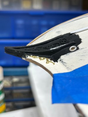

Hi Rob,
Where's the scroll work from? Printed? Purchased?
I had a sheet I purchased from Bluejacket...for their Redjacket model. I never use this stuff....because every model I ever build has some image that depicts the actual scrolling design, that has to be scratch built. However with Staghound.....there are no such photographs and vary little description...and thus I have artistic license here. I had to bend/cut and heavily modify what I had to fit and function on this models Hood and cutwater. Typically, I scratch build all of these items.....I tried something different this time.
