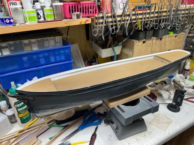

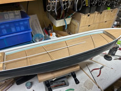

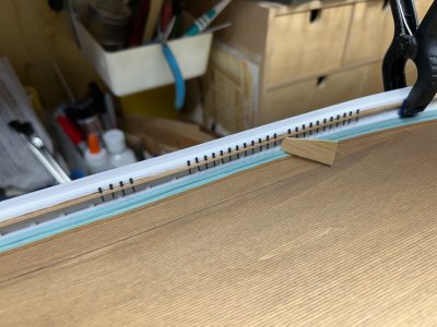

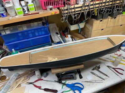

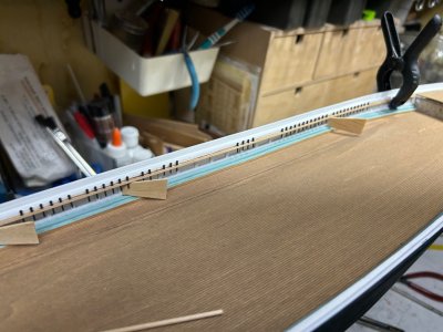

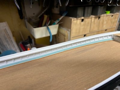

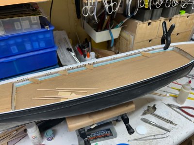

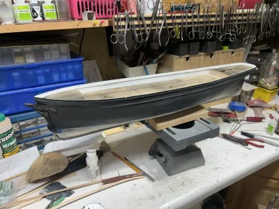

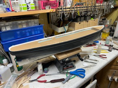

It does...but I don't like the glossy finish. I like my models mildly weathered and warn. Neat, but showing the results of exposure. A couple of unforeseen issues have arisen. The propellant of the black paint has reacted in some places with the existing primer paint and has caused micro buckling of the under lying finish. basically, the new paint has acted as a solvent on the primer paint and caused some slight defects in the final finish. I will sand those areas down and finish off with an acrylic paint without a solvent based propellant. No matter....it just adds to the realism of the hulls abuse.The black color give the hull immediately a different look, Rob. I suppose it gives you new energy.
I'm deciding whether to copper first or lay the stained decking first. Outside or inside......
Rob
