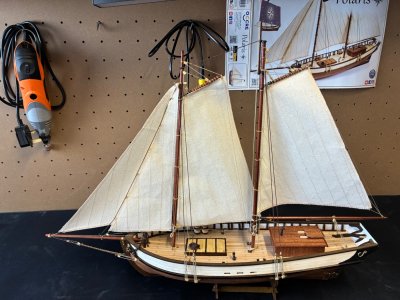

I started building my first model ship a year ago, no previous experience, and I started with an OcCre starter kit the POLARIS, just over £100 and that taught me a lot about plank on frame building. I made many mistakes and had lots of useful helpful advice from the many experts on here. Because of the mistakes, pointed out on here I had to remove and replace a few bits. All good though.
I take more time now than I did then.
The end result was pleasing to my eye and I then decided to build a wooden plane, Artesania Latinas Sopwith Camel, its still built with wood and now I am part way in building OcCre,s The Black Swan, this is more difficult than the Polaris.
Please just take your time and don’t start off with a ship thats classed for experienced builders. Heed the advice and ask as many questions as you want.
These guys give their advice willingly.
My first build
