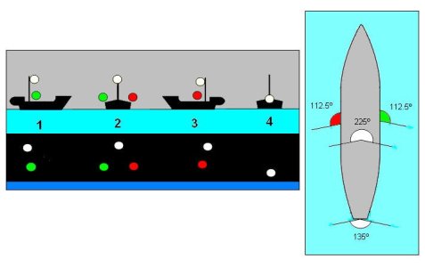

Based on this image I found on Wikipedia (https://en.wikipedia.org/wiki/Navigation_light), having the side navigation lights visible from the front and side only is correct, but if someone knows differently, I can make the lights to have a wider angle of view. The Wikipedia caption for this image is:
Basic lighting configuration. 2, a vessel facing directly towards observer; 4, vessel facing away from the observer
I believe that’s right. When you look at the pewter molded part in the kit, you will see what I believe is the way it looks. I’m not sure how I’m going to make it look like that.
