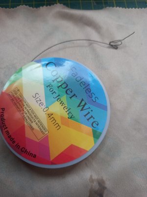

I am interested to know how the blackened wire works out. I have used uncoated copper wire then brush a little diluted liver of sulfur to turn it black once everything is in place. It has never been a problem, but if the blackened wire comes in all the same sizes and does not lose its finish when bending, it saves a step. Thanks in advance YT

The photo below shows some blackened copper wire I bought some time ago. I have screwed up the end and the coating seemed to survive.
