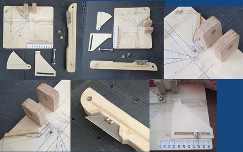

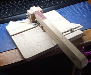

So are you going to show how you constructed this device? I would be very interested in building one myself.
What to say ..? I used:
- Plywood thickness 15 mm and 6 mm that I had in the "shipyard"...
- 1 standard cutter blade
- 1 bolt diameter M8 x 60mm + 2 washers + 1 nut
- 2 4mm self-tapping screws
- 1 piece of measuring tape of the ones that are given away in supermarkets
In short, a jic put together without pretensions using the first things that came into my hands.
I'll probably make a better one... in particular:
- I would make the right side longer, let's say around 200 mm
- I will replace the cross-head screws with screws with knobs
- I will make the angular striker with a circle-shaped milling for locking
- ... and other small improvements.
I hope I have been helpful.
