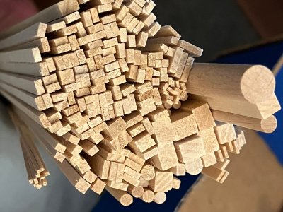

The strip wood is basswood but it’s of a reasonable quality, not too hairy and the grain’s tight. However, I do have pear wood and other goodies which I’ll substitute wherever I can. I’d rather let good wood show than have to paint ugly timber.

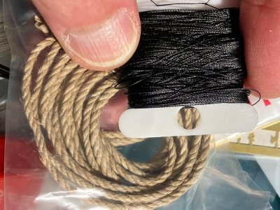

Cordage is not to my taste. The anchor cable is hairy string at this point though I may be able to improve it with shellac and a candle flame - not at the same time! The standing rigging is too shiny, too black, very obviously artificial. The running rigging varies in shade and shine from reel to reel but it too is a bit naff in my opinion. Other opinions are available. Other thread is available too so that’s an easy fix.

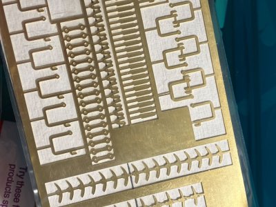

There is a small fret of photo-etched brass (PE). The etching is sharp and the brass is reasonably thick. I have no complaints about this.

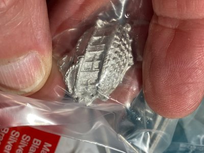

I think that’s hideous. The windows to the officer’s toilets. Since it’s such a gloopy casting and since the entire thing is totally different in style to the rest of the more workmanlike boat I’ll omit it. They can poop in the dark!

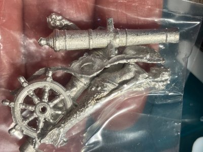

The rest of the white metal castings are little better. I’m reminded of the cheap toys that we found in Xmas crackers back in the 1960s and this is an expensive kit from 2010. The figureheads is spurious for 1803, not being fitted until much later so that can go too. The long guns are similarly rubbish so my desire to avoid aftermarket is already a thing of the past.

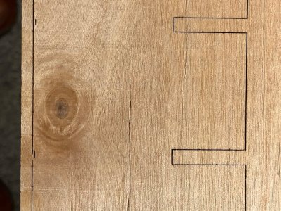

Laser cutting and etching of bevel lines etc is very good. The kerf is thin and the charring, while very black, isn’t deep. The surface layer of the bulkhead looks a bit rough though. Let’s look at some more of the plywood.

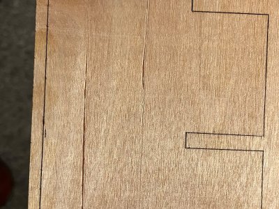

Hmm, cracks and open splits in the veneer layer.
A large knot.

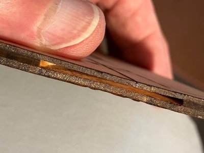

What’s going on here?
A void. Avoid using plywood like this for ANY purpose Mr Shipway. And that void was there before and after the laser cutting, clearly visible to the packers too.

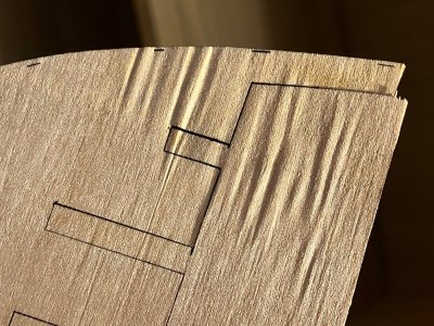

And of course with material like this the BF and the bulkheads are all a little warped. The manual says “if your bulkhead former is slightly warped it can usually be straightened out by using filler blocks.” Usually. Later on the book there are photos of the prototype under construction showing bulkheads that fail to align with the template. Apparently, “This isn’t such a big deal.” Makes me wonder why they provided a template at all.
A large knot.

Based on the photos you posted I think a lot of us agree with your assessment.
