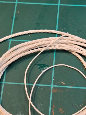

Sorry. I may had misunderstood. You meant a rope walk meaning a rope making machine. Then I would recommend this machine. I use it all the time. I give it 5 stars.

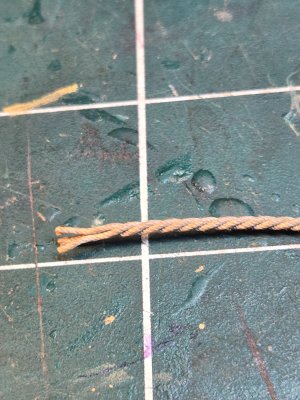

Tested. First trial. I am very happy. I used 4 ropes. The starting rope is in the middle of image. More than enough for my objectives.
As we have debated endlessly, many modelers feel that results outweigh being able to say that “I made it myself.” I offer this in that sense.

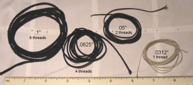

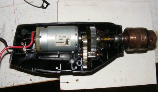

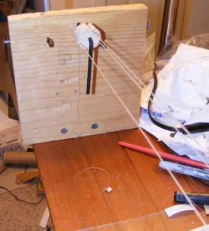

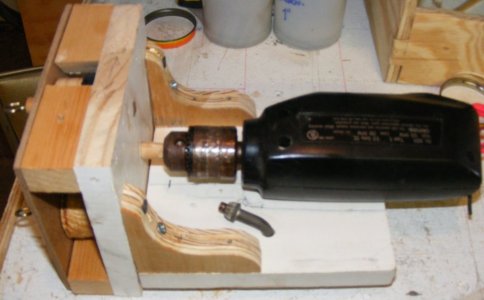

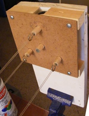

I made a rope-walk years ago from an old Craftsman cordless drill and some plastic gears that had something to do with RC dune buggies. I ran it from a 12volt SLA battery to walk off 12+ foot long lengths of line. Since my models are large scale (1:36 & 1:20), I tend to need larger diameters, and since they're working radio-controlled models...

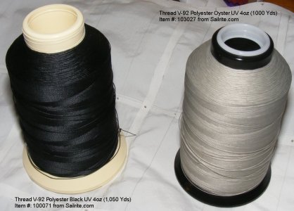

...I use Dacron sail thread because natural fibers would be gone in no time just from sitting outside on a display table.

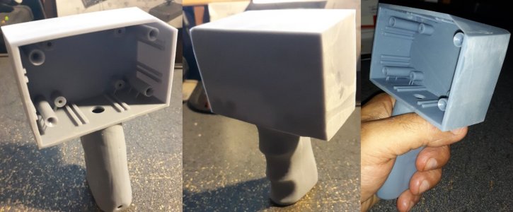

I'm about to rebuild the machine, I 3D printed a handheld controller with an electrical box and an AR15 grip, which will hold switches to work the machine and allow me to walk it's length as needed (remember those 12+ foot lengths). I'm also going to run it off a power-supply instead of a battery.
