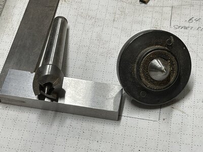

@Vfordyce , in the above pic on the left is a spur centre and the right is a live centre. Spur centre is used in the headstock normally when trying to turn square or odd shaped material round. Live centre is used in the tail stock to steady or support the material you are turning.
If you are using a dowel use a three or four jaw chuck to hold the dowel. Put dowel into chuck and if possible push it though the headstock until there is only a small amount left sticking out of the chuck. Tighten the chuck up a little just so that the dowel won't slide out, bring up your tailstock, with the live centre mounted in it, and mark the centre of the dowel with the point of the live centre. Now loosen chuck, move tailstock back and pull out dowel to desired length. Tighten up chuck and slide tailstock up to dowel making sure the point of the live centre is located in the mark/hole you previously made. Tighten down tailstock and live centre then start turning/sanding your wood!! The two block method previously mentioned is a real good system!

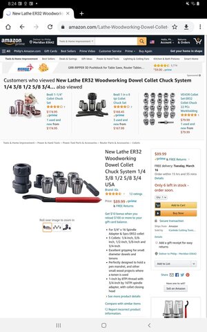

And remember, there are collet systems to hold dowels and rods while turning.View attachment 220647
