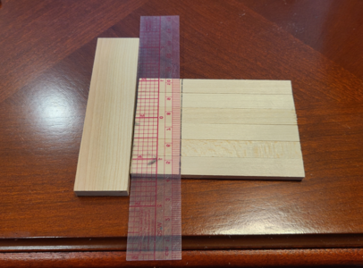

For pieces to test, I used the 5 x 10 x 120 mm railroad ties included with the Occre Large Locomotive Stand. There were 17 included in the kit, so that gave me 8 pairs to test. (I hadn't used these pieces, as I wanted to have more and nicer ties, so made 28 of my own of cherry wood). These are a white fine-grained wood, softwood I think, but am not sure.
I planned to overlap the pieces by 1", giving a reasonably large gluing are, so marked one piece accordingly:

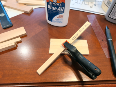

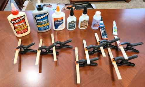

I glued each pair together with the 1" overlap, and marked one side with what glue was used:

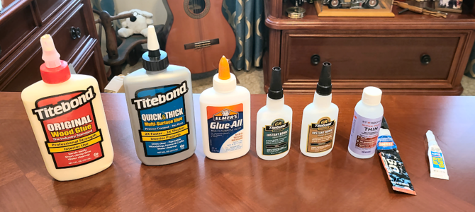

I chose these glues for the test (mostly because I had them on hand and have used them all in the past):
  • Titebond Original Wood Glue is probably the most popular glue, PVA, not waterproof but considered very strong.
  • Titebond Quick & Thick Multi-Surface Glue is a thicker version that doesn't drip and cures more quickly. I've had good success with it in modeling.
  • Elmer's Glue-All Multi-Purpose Glue I've always considered more of a "School Glue", and didn't expect much strength, but was surprised.
  • Titebond Instant Bond Wood Adhesive - Medium is a relatively new super glue, designed for porous wood rather than non-wood smooth surfaces.
  • Titebond Instant Bond Wood Adhesive - Gel is a thicker version of the Medium above. They also make a Thin version.
  • Starbond Super Fast Thin is a very thin super glue not really designed for wood, but I thought I'd try it as it seeps into narrow gaps quite well.
  • Loctite/Heinkel 60 Sec. Universal Glue is a super glue with a thickener, which tacks things together initially, but allows movement for 20 seconds or so, then hardens quickly like super glue.
  • Duro Super Glue came in a pack of 6 or 8, cheap at Walmart, so I wanted to see how it stacked up as well.
All of the glues along with their glued samples:

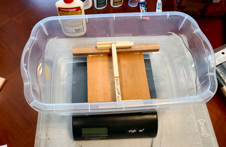

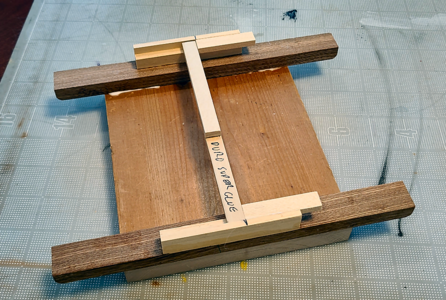

I then made a jig to hold the pieces in a consistent manner of scrap on hand:

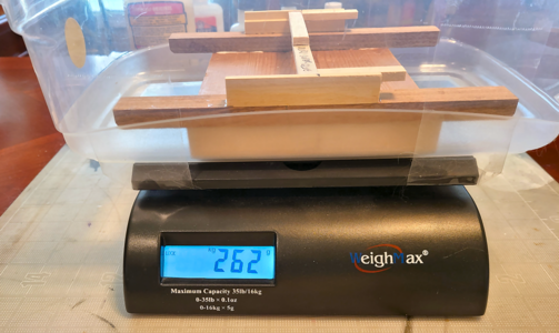

I then placed the jig into a plastic box I have attached to a 16kg capacity scale that measures quite accurately.
I use this scale to weigh our cats occasionally (thus the containing box) as well as other items.
The scale arrangement is then like this:

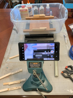

From my previous testing, I knew it would be difficult to determine what the exact reading was at the moment of failure, so decided to take a video of each test. This is the arrangement I ended up with that could read the scale reading best:1665943045116.png
I found it difficult to press hard enough with my thumb or knuckle, so ended up using a round plastic rod I had on hand, held in both hands, and pressing slowly:
I typical recorded test went like this:
View attachment Titebond Instant Gel_Trim.mp4
(This video had to be trimmed in length to be able to upload)
I then scanned each video, frame by frame, to determine the maximum force in kilograms that it took to break each sample. These are tabulated in the table below:
