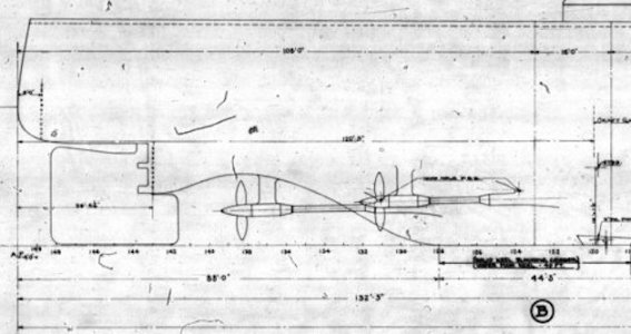

can you post a profile picture of the stern to see if they molded the armor belt or not & a picture of the bottom of the model for docking keel locations?
are you going to taper the prop shaft housings that are part of the hull that the prop shafts come thru as shown on Sheet 3 - Outboard Profile of the ship's Booklet of General Plans 1941 or leave them with blunt ends?

EDIT- I found a plan of the ships propeller shaft housing, and see the issue.

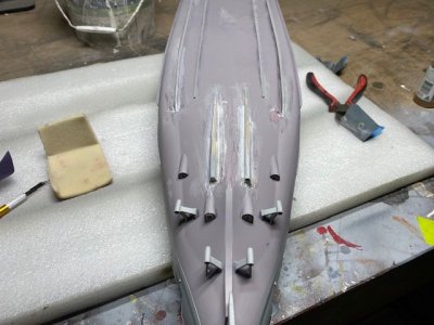

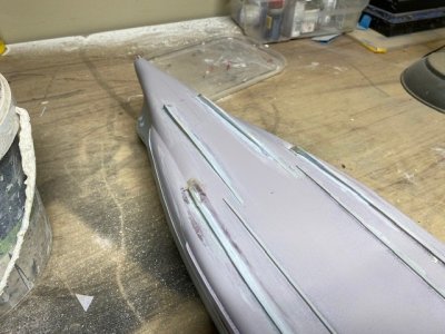

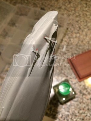

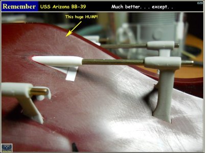

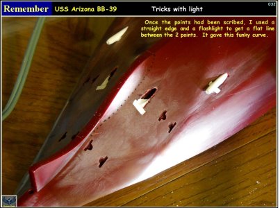

I did find a photo of a 1/350 scale Arizona with propeller shaft modifications on the internet. ( Sorry for the poor photo.)

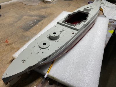

been looking for another ship model for some time, and finally jumped at this kit when it was discounted recently. This is the start of my new build log for the USS Arizona.
I have assembled the main hull and deck pieces together. Thanks for your interest.
View attachment 515648View attachment 515649
Good luck with this build Brian. You've already made some decent progress; you're ahead of me on the hull at present as I've been focussing on sub assemblies.
Wow, you're way ahead of me with the docking keels. What have you used to replicate them? Evergreen strips?? Looking good mate. Hope to get on top of mine this weekend.
Thank you my friend. I'm not sure whether my docking keels are 100% accurate, but its the best I can ascertain with the plan drawings . I used thin 1mm timber planking for the keel construction along with 2 part epoxy filler.
how wide are your docking keels as should be 2.286mm for 1/200 scale as they were 18" wide on the real ship? do you have a link of that stern plan you posted above? don't use that picture as a reference as i see issues with it. what are you using to measure with?
BB-39 USS Arizona Booklet of General Plans (1941) https://archive.org/details/bb39bogp1941
nevermind the plan link as i already have that plan as thought yours was familiar til i found i already had it.

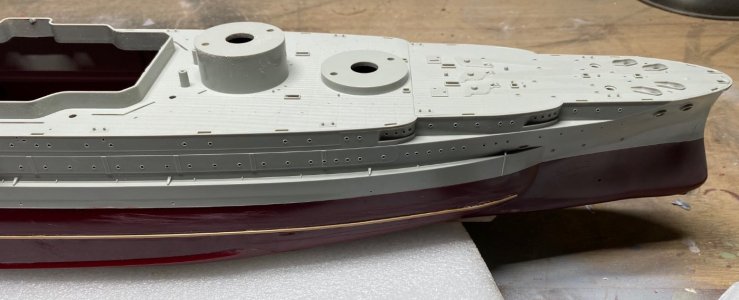

Anchor Hawse holes in the hull the incorrect shape
Upward sweep of the keel between propshafts incorrect, a lot of material removal required here and the lower after hull need filling with casting resin to allow removal of this hump
Obviously you have dealt with the docking keels. Apparently White Ensign models provide a template for these in their etch set
The forecastle plating is the incorrect pattern where the anchor chains run
The Casemate guns sit too high in their openings out of the box
These Casemates need the lips removing top and bottom as hugely overscale
I do remember vaguely from the article I read that the kit bow was too fat as it came to a point and needed to be much more slender. I can roughly remember the builder chopping the forward section of the hull apart and rebuilding as you would as in the stern issue, just sand through the hull

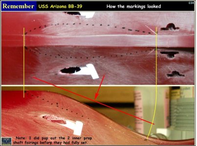

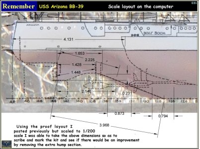

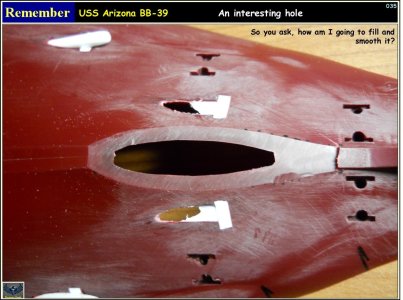

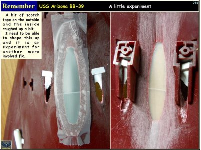

David, do you have other photos of hull modifications by the model builder above ?
