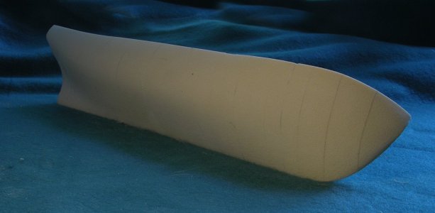

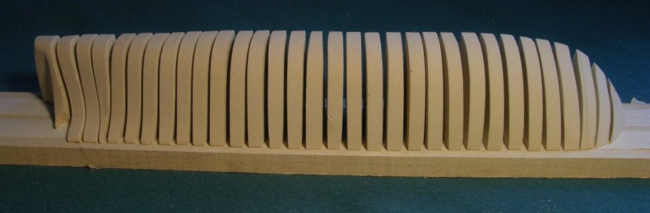

you can skip the tedious job of lifting frame shapes from hull lines, plotting the bevels etc and just carve out a 1/2 hull from a dense foam board the slice it at each frame location. You still have to trace around the slice but it so much easier and faster than lifting each frame shape from hull lines.

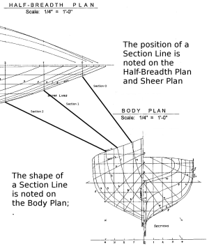

each line is half of a frame. you trace each line, then flip it over and trace the other half to make each frame.
imagin if you cut out each frame and piled them up, that is what it would like. they are also numbered to coincide with the side view of the hull also numbered where each frame is to be installed on the keel.
One side of the body plan represents the shapes of the section lines from midships to the stem. The other side, midships to the stern.
If the section lines are too far apart to use as frames alone, additional section lines can be generated by simply constructing a series of points between two existing section lines which are exactly one half of the distance between the two adjacent provided section lines on any diagonal and connect those points using a batten or drafting curves to construct intermediate station lines.
Frames do not always fall on section lines, nor even always are equally spaced. In such circumstances, the shape of any frame can be constructed at any point on the hull using the distance from the centerline to the side of the hull at each waterline as in the above half-breath plan.
Of course, as Dave noted above, there's no need to mess with frames at all if you build a solid hull of stacked waterline shapes, which is a lot faster and easier than planking on frames or bulkheads. Actually, the way most all the great contemporary models to be seen in museums were built, save those which intentionally were left unplanked to show the structure of the framing (e.g., many of the Admiralty Board style models,) are constructed with built up lifts.
