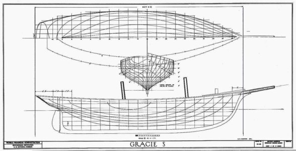

Lofting
The key plans from HAMMS will be 0011.tif

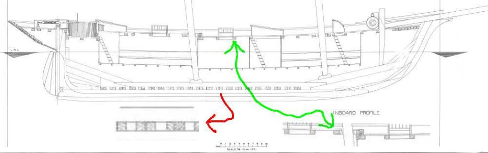

Provides the evidence that the framing is all bends, 8" sided, 10" space (red arrow).
The location of the deck beams and the height at the centerline. (green arrow) I would make the deck beams. Trim and temp fit them in position and measure the roundup for each one separately. Measure the distance from the rail to the crown of the beam. Add the beam thickness and the roundup. Make a gauge to site the top of the deck clamp at each beam.

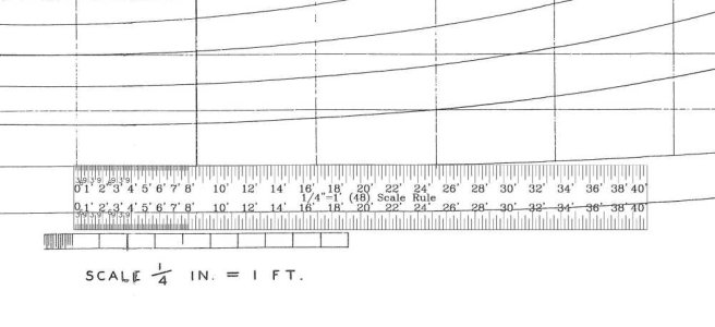

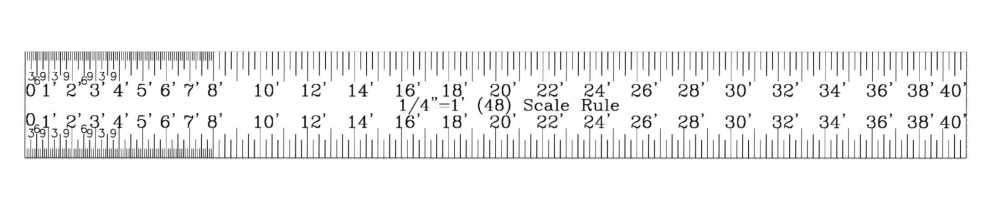

A tool necessary here is a 1:48 ruler that has been scaled in my drawing program (Painter19) to print out with identity with my architects triangular scale.
The white background is CUT. The ruler layer is transparent except for the ruler black.
The plan is checked and the scale is adjusted.
Tiff to PNG 51.9% is my scale correction factor.

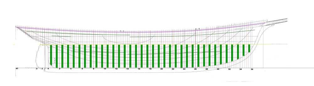

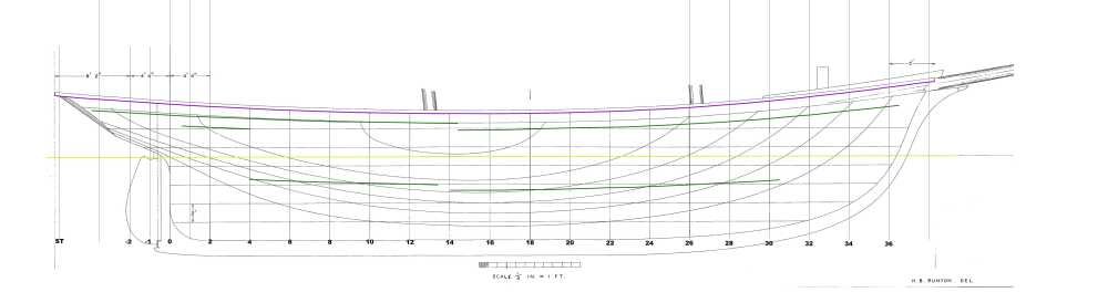

The profile is processed first.

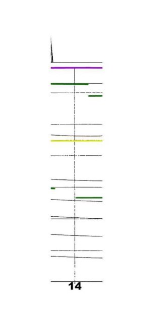

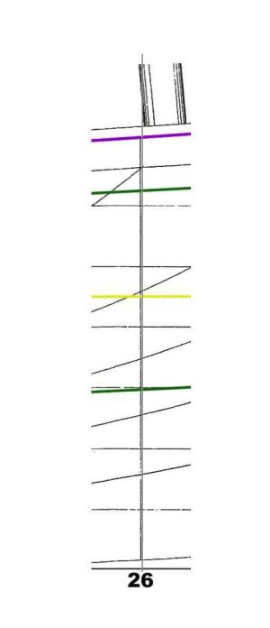

The lines that are needed are color coded. The stations are made prominent and identified.

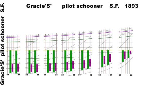

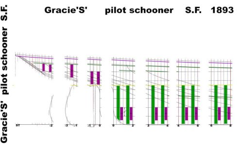

The frame lines and spaces.

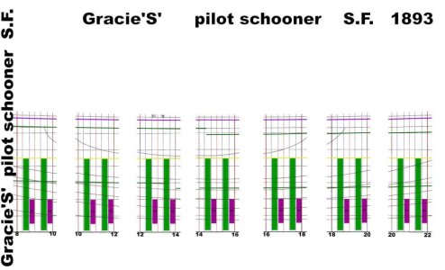

The assembly guide is extracted and printed.
The data for each station is saved as a separate layer.
