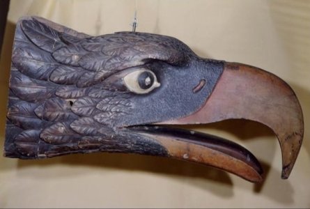

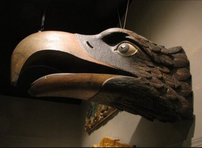

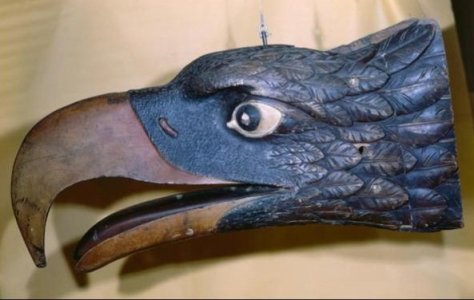

While searching for a specific painting in the online Mystic Seaport Museum gallery, I came across these images of the large eagle figurehead taken off of Great Republic. There would have been more to the eagle's neck since she was obviously severed from the ship's prow. Typically, a figurehead's position was set so that they were looking straight ahead. From the raptor's head position, it looks like her neck would have angled down to accommodate the ship's bow. You'll want to consider that when you model your eagle for your model.

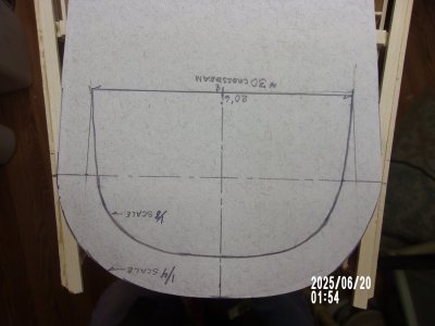

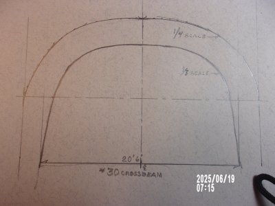

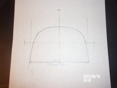

Doing some work on the stern again. I copied this from a drawing in 1/8th scale by Mr. Crothers so I hope it will do. What do you think? I'll have to expand it to fit the model.. Rob too. Pete

Here is the same picture in 1/8th scale as above and the actual curve to use on the GR in 1/4 scale. The top line is an exact copy of the lower line although it does look more rounded than the bottom line. Comments please. Here she is with a bare bottom.

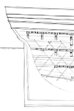

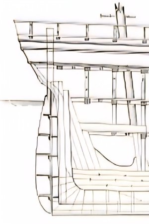

Here are 3 equal cross-sections of your subject to give you a better idea of how this area was fabricated. Interestingly enough we observed a similar stern construct on Glory of the Seas. Her aft section looked round but actually it was a series of straight sections creating an elegantly curved appearance.

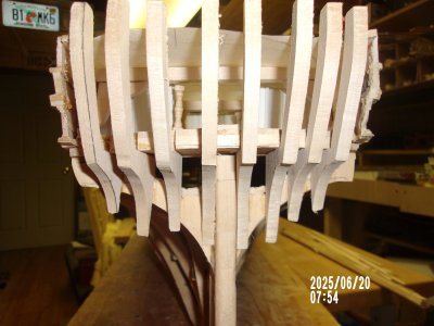

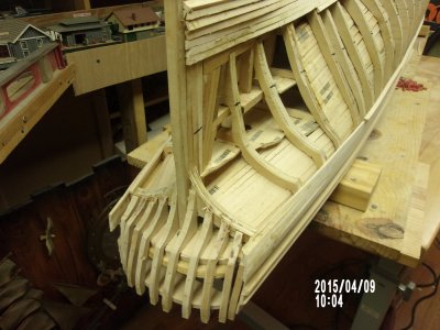

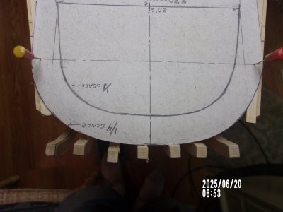

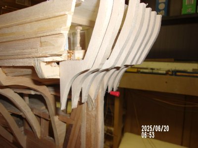

Actually I do want the Eagle on the bow but I hadn't got around to the stern decoration yet. Those are three good pics of the figurehead to go by and we'll have to see about the color. Do you have William Crothers book on clipper ships? There is a chapter in it about figureheads that I'll have to study pretty soon. Hopefully it has some answers in it for us. I have already posted a picture of the stern minus the end. I'll post some new pictures now of the pattern I used to define the eliptus and how the frames look all attached but not yet trimmed. Waiting for the glue to set overnight and then I'll put dowels through each timber at the bottom and at the deck level to hold the timbers in place. Should be good and strong so I can use a sanding block on them without snapping any off. I think I might have it right this time. I had to stop planking the hull to get this in place as the planks end at the stern and are incorporated into the knuckle somewhat. It's amazing how one little thing in one place effects two more things else where on a ship. Also thanks for the three pics of the stern. I have them too in Crothers' book and they are very useful. Pete
#1) Empty stern
#2), Pattern in place
#3) Cut ten frames but only used 8--so far
#4) Stern frames in place but untrimmed
#5) Same pattern with timbers adjusted for form
#6) Will drill and set dowels in the bottom and at deck level for each timber
Hopefully this will keep the frames from snapping off or coming loose when I start sanding them to form.

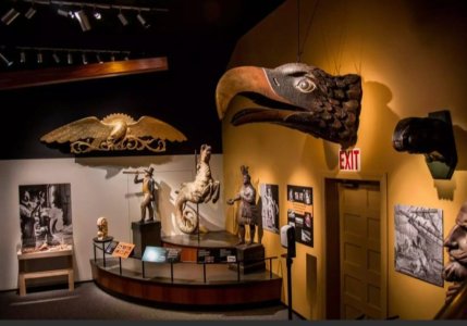

You're correct that the original eagle figurehead was removed from the burnt out Great Republic hull almost immediately after the fire and was later replaced by a billethead when she was floated and rebuilt. Incidentally years ago, I saw this large regal figurehead in person when it used to be an outdoor main display to the Mystic Seaport north entrance. To say it was imposing is an understatement.
This original Great Republic bald eagle figurehead is currently now on display in the Figureheads & Ship Carvings display at the Mystic Seaport Museum, Mystic, CT

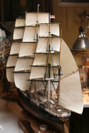

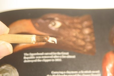

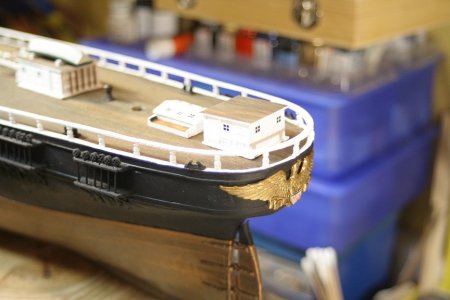

I painted the shield. Just keep looking, you will find what can work. Or carve your own as I did with the figurehead.
I opted to keep her brown to show off her eyes and detailed beak. I thought she’d look washed out all while. My choice anyway.
Rob
Rob,
That stern eagle with American shield is just perfect. If @Norgale is working on 1/48th scale of 1" = 4' his 36' scale stern eagle will have a wingspan of 9". Meanwhile his eagle figurehead would be 1 & 1/4ths" & a bit longer if he includes a bit of shoulder which blends into her diminutive cutwater as illustrated. Since he asked what color the eagle was originally painted, I reported what historic documents appear to show. Since her hull and bowsprit were both jet black, maybe a contrasting dazzling white figurehead would be more noticeable.

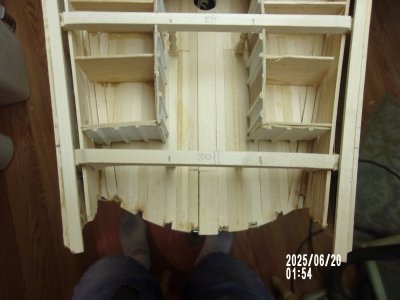

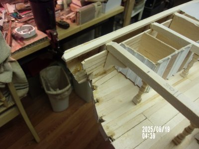

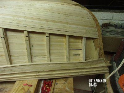

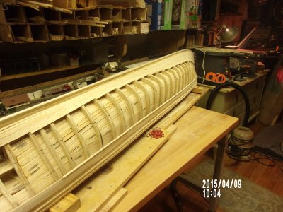

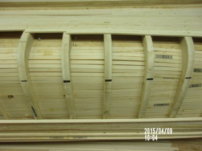

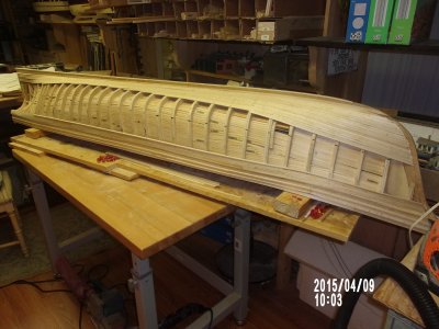

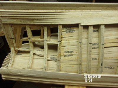

Now that I've had my lunch I can enjoy my iced coffee and a smoke while I ramble on about the GR. The planking is going on very well but I'm at a loss as to how the planking pattern should go. As you can see from the pictures, I've started at the keel and the top deck and worked towards the middle but now I think I need to do more accurate planning for how the planks will run. Any advice? Lots of sanding and mudding to be done yet and some of the plank ends are not glue down yet so there is that to do too. I received my moulding forms yesterday and the last plank up from the table is moulded. It was easy to do and will look nice when it's painted I think. So here are a few pictures of the planking.

Looks great Rob. I've never tried to carve anything so I'll have to give this a shot. Pretty tiny compared to the real one. Pete
