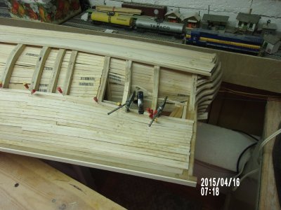

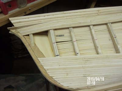

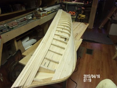

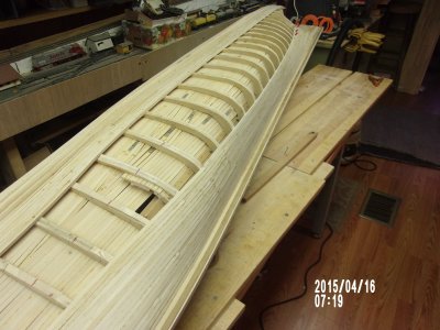

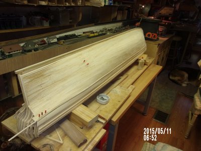

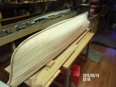

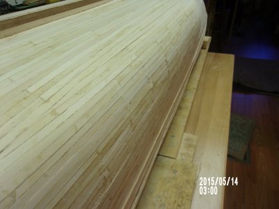

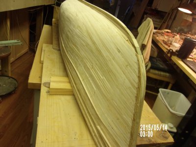

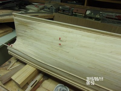

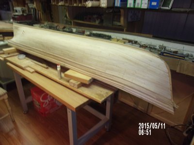

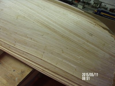

Worked some more on the planking and have finished what I started at the bottom and the top of the hull. Still have a wide area to plank but I have to start tapering the planks so they will all fit. I have room for 28 planks at the middle of the hull and 20 (full sized) at the stern. I divided the 20 by the 28 and got 71%. Does that mean that I should taper each remaining plank so that 71% is left at the end of the plank or am I going the wrong way with this? Never had to do this before and it's a bit confusing. Also looking at the water line, it seems to be way high up on the hull. The top black marks on the frames is where my plans show it to be. Does that look ok? Seems pretty high to me.

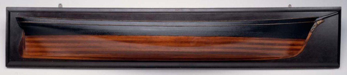

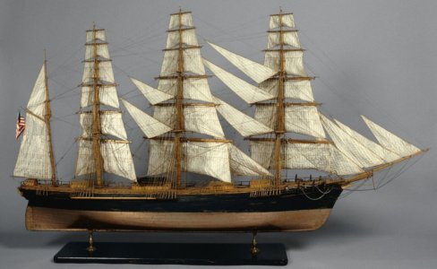

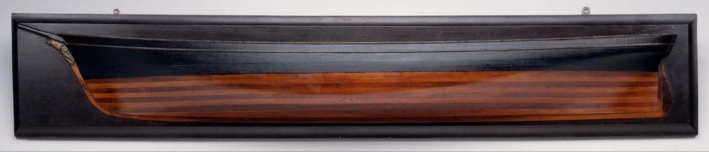

All ships have waterlines that are deeper below their hulls than above. According to McKay's booklet, Great Republic was "yellow metalled" (Muntz metal) up to 25 feet draught. At a scale of 1 inch = 4 feet, that's 6 & 1/4th inches deep. Examine these images, it's clear that the waterline below is deeper than the section of hull above.
The half model and the two photos look much better so maybe with my hull up side down there was an optical illusion of the water line. I wonder if the half model is the one donated by the McKay family? Do you know who made the model GR and where it is? Nice looking model.
@Norgale

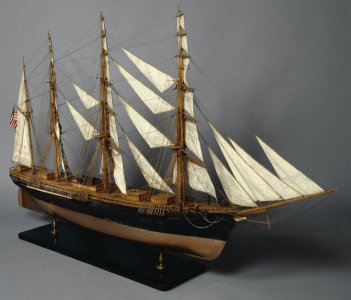

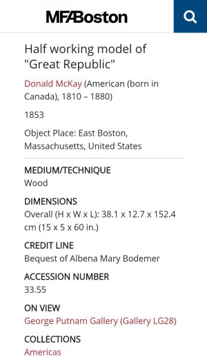

The Museum of Fine Arts, Boston (MFA) has this description of the Great Republic half-hull model. It was apparently built by Donald McKay himself.

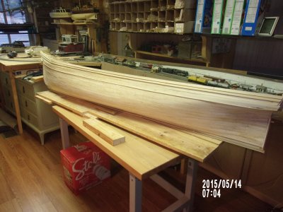

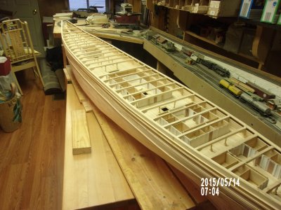

Got my computer working again and all is well --so far. Finally finished the planking
I thought it would never get done but now it is. I'd like to know if any of you have or know of a sander that is small enough for model work and tough. That's my next job on the GR and there is a lot of sanding to be done. I have several sanders but they are all too big and heavy. Need something small and light I think. So now I'm out of lumber for now. Need some more to finish the top deck. I read a post on here that someone wanted to see this hull when it was all planked. Here are some pics of that along with a few others. I'm getting pretty tired of working on the GR so I just may put it up for a spell and build something else for awhile. I need to clean up my work room and get rid of a lot of junk so maybe I'll work on that too. Cheers!
It's also time to build a cradle for this thing. I'm thinking something about two feet long made with large timbers and some decorations on it along with a brass plate stating the name and birthday of the ship. Maybe the builder too. Sure could use some suggestions. Pete

Congratulations with this milestone, Pete. Now you can see het gorgeous lines.
@Norgale
I swear that I have paddled canoes smaller than your Great Republic. OMG she is gigantic!!! And a quite beautiful hull too.
Hi clipper fan. Ya , it's pretty big. I think I should have gone smaller but it's too late now. Can't wait to get going on the rigging and masts. It will look a lot better when some of that gets applied. Working on smoothing out the planks and fixing things that don't look quit right. I'll need more lumber to finish the top deck too.

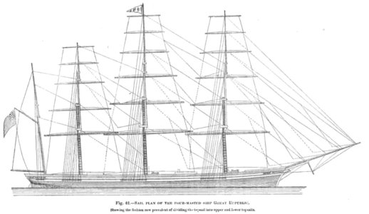

Pete,
If your lower masts almost reach the ceiling lights then you have a big challenge facing you when you start adding topgallant, royal and skysail masts. You might want to measure total installed height first. One idea might be to do an enlargement of the sail plan from the McKay booklet. I know Staples will do poster sized images. 1:24th might not be practical but 1:48th might work. Then you just double up all components. This is a very exciting project to follow!
I just measured the bowsprit and compared that to the main mast and the mast is a bit over twice the length of the bowsprit outside the hull. But there are many things to do before I get to the rigging. All the deck stuff needs to be assembled and machinery to try and locate along with the standing rigging anchors on the outside of the hull so there are lots of things ahead of the rigging to do. Every morning I go into my hobby room and see that boat sitting on the work bench. I look at it and wonder how I actually got this far with it. It is very satisfying to watch it taking shape.
I'm not sure what you mean by doubling up the components.The scale is 1:48 so why wouldn't the sail plan be the same thing? And that;s another thing, making the sails. There's no end to it. Ha!
@Norgale, Pete my suggestion was to print out the McKay produced Great Republic sail plan as a shortcut to being precise for all masts and yards. Since I'm unsure that Staples or other print companies can print out a 17 foot × roughly 15 foot document, I suggested seeing if a smaller size say 8.5 foot x about 7.5 foot could be feasible. If it was, that would be 50% of the size you ultimately need. Then you would double up everything to get to your desired scale.

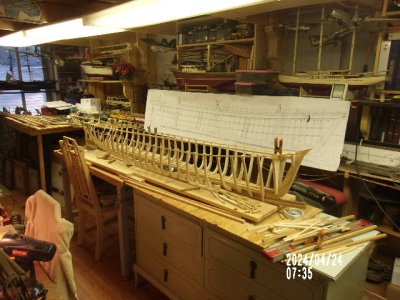

In William Crothers book about clipper ships there was one page where he had a side view of the GR to a very small scale. Maybe it was a bigger picture reduced for the book. I took a copy of that page and went to the Midwest Copy store where they specialize in construction plans and asked him to enlarge the page sized picture to 1:48 size. All he needed was one measurement on the plan that we knew the measurement for and produced a two foot wide by eight feet long reproduction . This picture shows part of the plan. I was amazed at what he could do with his machinery and have been going there for many years now for all kinds of printing work. The enlarged print has been my bible for building the GR. It's not exact as some size has been lost in the reproduction but it's close enough to build the model. I have one other drawing at 1/8th scale that Mr. Crothers drew for me and it shows the configuration of the ships cabins and buildings on the second deck and the top deck respectively. I intend to have it enlarged too to the 1/48th scale when I start doing the top deck buildings and machinery. I see no reason why the Midwest man can't do the sail plan too for measuring the sail sizes. I haven't arrived at that point yet.

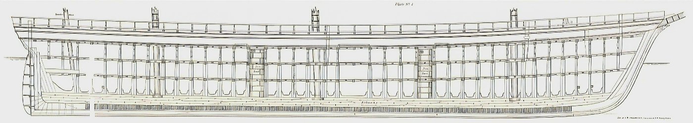

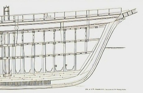

Pete,

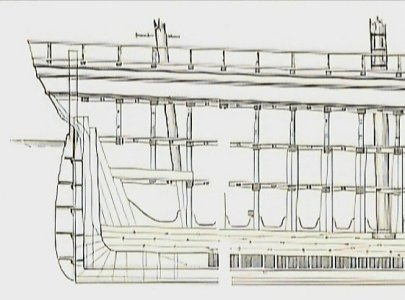

I find images of drawings like this very problematic indeed.
This drawing depicts her with a bulwark and forecastle splash rail. She didn't acquire these until after her rebuild. This drawing also shows her with her Eagle figurehead. She had her Eagle removed when she was rebuilt and a plain *billet* was fixed in her stead. Her original sail plan called for only skysails...but she did get skysails when she was rerigged in the *Howes* double topsail configuration. This drawing depicts her with the modified *Forbes* single topsail....that moved up and down the topmast doubling. This drawing also depicts her with, main course, single *Forbes*, topsail, topgallant, royal, sky and moon sails.
This rendering mix and matches pre and post reconstruction features....confusing the reality of her TRUE original configuration. She didn't have her Eagle figurehead and a bulwark. She didn't have Forbes rig topsails when she was rerigged. Her main yard was 120ft long when original...this main is 20ft shorter.....depicting her rebuild. This drawing is a convolution. Sorry to say.
Rob
