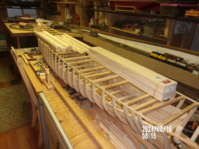

Ships lumberyard for lack of any other place to put it.

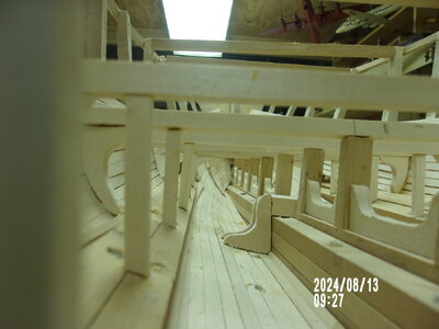

A view down one side of the ship showing one of the mast steps.
A view down the other side of the ship showing the opposite side of the mast step. Can't tell port from stbd. from here.

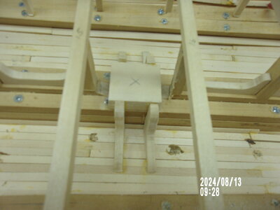

Top view of mast step.
