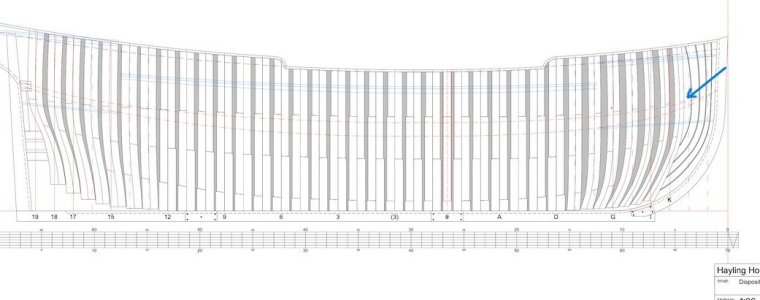

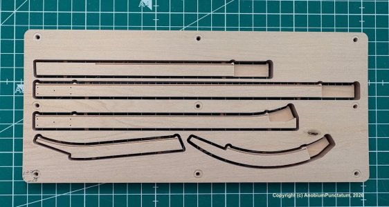

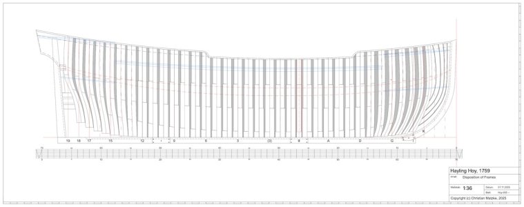

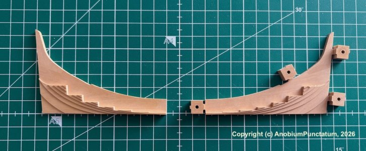

In mid-February, I began building the parallel frames. As shown on the Disposition of Frames plan, the parallel frames consists of 21 double frames and one single frame (midship frame).

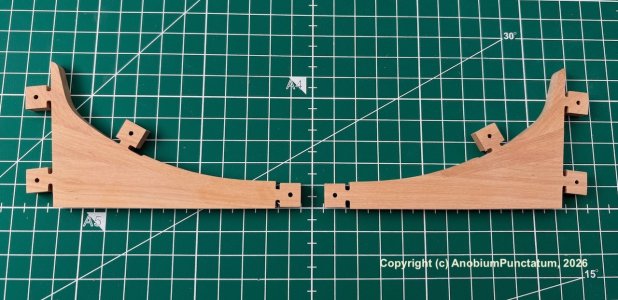

To compensate for any inaccuracies during assembly, I added 2/10 mm to the inner and outer sides for the frame thickness when preparing the individual parts for my CNC machine. Only time will tell whether this allowance is sufficient or if I will need to add another 1/ to 2/10 mm in the future for my next project.

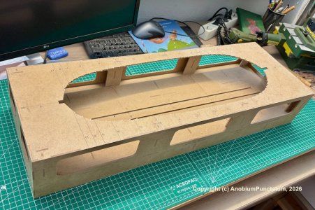

Due to the tight tolerances, I milled a small jig for each double frame. This allows the components to be assembled very precisely and quickly.
Originally, I had planned to use a two-part template; however, this idea didn't work out as intended. So I decided right away not to use the upper part of the template after the second frame.

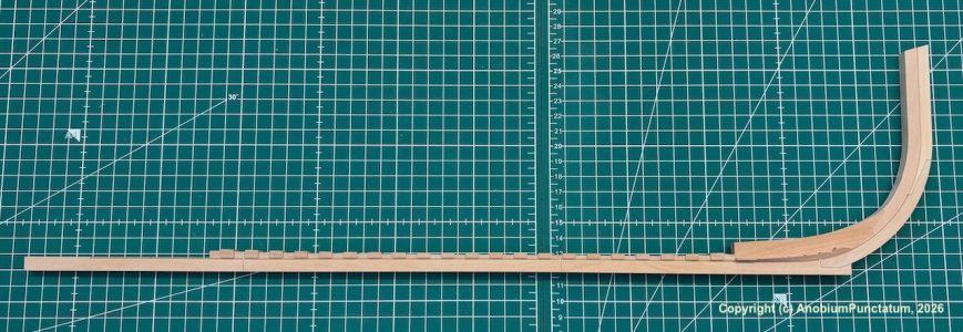

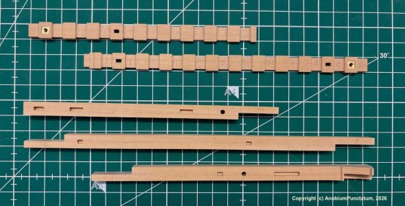

One half of the frames consists of floor timber (10'‘), second futtock (9’'), and toptimber (8'‘), while the other half consists of a crosschock (9.5’'), first futtock (9.5'‘), and second futtock (8.5’').
First, I assemble the half consisting of the first and second futtocks in the template.

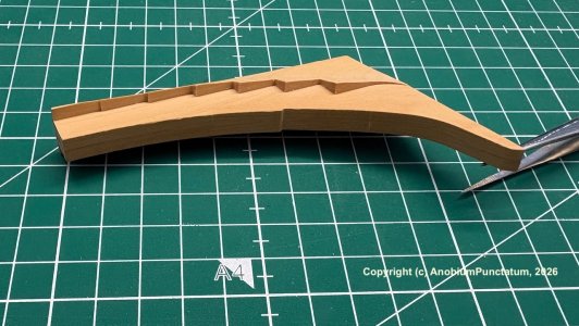

Then I glue small spacers onto the second futtock to compensate for the 7/10mm offset. Now I flip the component over and place it back into the template. Now the other half is glued onto the first half. The small part shown in the photo with the individual frame members is very helpful for aligning the floor timbers.
I assembled the floor timbers for frames 10–12 from two separate pieces. This way, the grain of the wood aligns better with the direction of the frames. David Antscherl described this technique in his book "The Fully Framed Model", Volume I. You can’t see this on the finished model.
(The photo is from my Alert project)

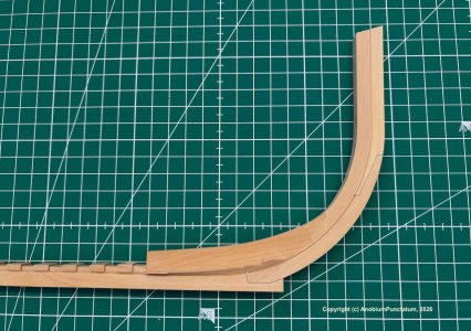

The little assembly jig was very helpful; still, adjusting the cutouts on the rising wood was a time-consuming task.
The next two photos show frame D (the first fore parallel frame) before and after the adjustment. You can clearly see that the frame was about half a millimeter too high at the start.
Here is the last parallel frame before the aft deadwood. This frame is also still sitting a little too high.
By mid-May, I had assembled all the parallel frames and had them mostly fitted to the rising wood. You can already get a first impression of the hull shape.
