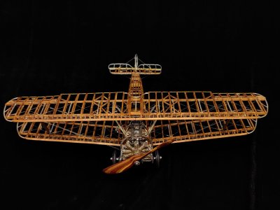

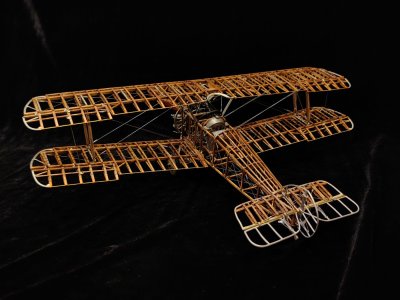

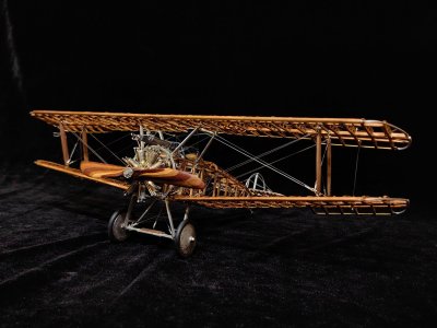

Hey,
really beautifully built and beautifully staged. But I have one question: Isn't the beam towards the rear too short? Nevertheless a very nice model, well done! Thumbsup

Hello, friend. I've seen your reply.
My translator translates "beam towards the rear" as "backward beam/crossbeam". I'm a little not quite clear about exactly where this crossbeam you pointed out is. Could you please take a look for me? I'm a little confused.
