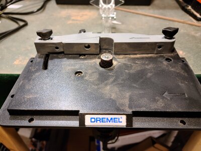

For my daily small projects I will continue using my dremel sanding drum on my dremel routing table (see picture). For medium size jobs I will use the EJWOX. When the needs come for a bigger benchtop spindle sander, I will buy the Jet model.

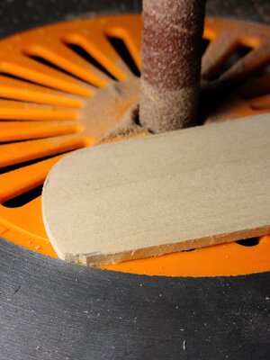

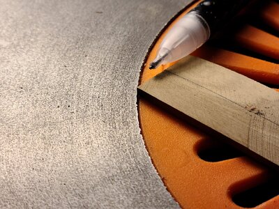

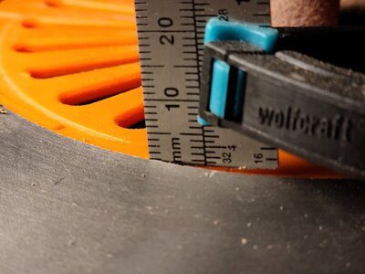

But the WEN also has an issue that bothers me.
The plastic ring around the drum is NOT FLAT to the working surface. So my small pieces of wood are stopped (stuck) when I move them around flat to the surface. The plastic orange disc is 1 mm below the metal surface of the table.
See pictures so you will understand.
Today i went to WOODCRAFT to buy the JET spindle sander and started the Amazon return process.
To my surprise the JET has the same issue. Woodcraft has a teaching room and they have a JET in use. We tried it and the same issue, the wood was stuck in the border, like the pictures of the WEN.

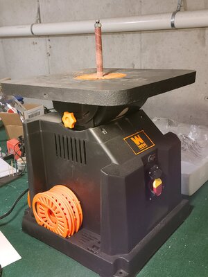

I came back and decided to keep the WEN. Added a piece of veneer that solved the ring issue and tested a speed controller i ordered during the week.
All works PERFECT.
I uploaded a YouTube video for you all to see how the speed controller works and the level of noise at full and reduced speed.
I am very happy now with the results.
