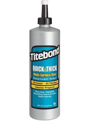

When ordering some more Titebond III recently, I added a bottle of Titebond Speed Set to my cart on a whim, figuring it will eventually come in handy. I finally used it a few days ago and was pretty impressed. They market it as "50% less clamp time" and I'd say that's spot on or even conservative. In my case, the piece was pretty thin and not under much tension but in a spot where clamps wouldn't work. I spot glued the piece and hand clamped it for maybe 15-20 seconds and it was already starting to take hold. In fact, once I realized it was setting so quickly, I had to pick up the pace a bit to make sure the rest of the piece was aligned before gluing the rest. Good stuff...does anyone else have experience?

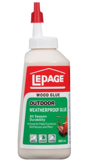

I figured it out searching Google. Titebond II originates in US and was first single-component wood glue to pass the ANSI/HPVA Type II water-resistance test. Regular Canadian LePage woodglue is not as water resistant as Titebond II but PePage OUTDOOR is exact equivalent.
