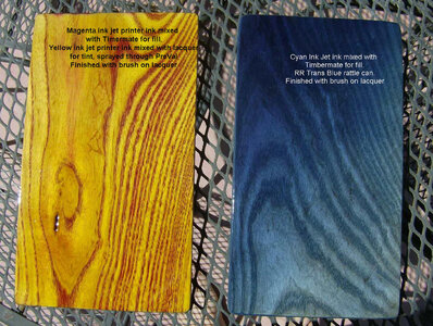

I didn't see it mentioned but another option for dyeing wood is ink jet printer ink. As I recall, most of that ink is water soluble, but don't quote me on that. I can't remember what I used back in the day, but I'm pretty sure it was water.
Just buy those refill bottles, and start mixing. Pretty cool the colors you can come up with using that ink.

I dug up this pic from back when I was doing guitars, jogged my memory.
The wood is swamp ash. I used the ink jet ink as a tint in the wood fill and in the shellac.HPIM1242.JPG

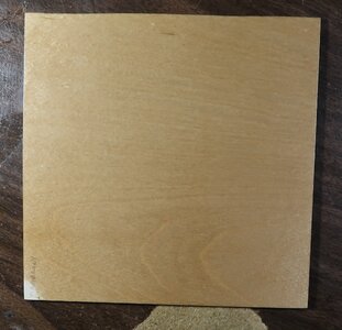

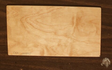

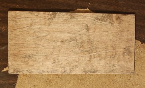

Here's some examples of different stains I was playing around with on birch plywood. I knew going in that staining birch was going to be a little tricky, but I was more interested in color than the actual finish.
Each piece was properly prepped including using a pre stain conditioner. All stains were Min Wax oil based stains.
Colonial Maple:
Special Walnut:

Don't get me wrong, I'm not saying it can't be done, just saying that some woods are trickier than others when it comes to stain. I'm sure there's plenty of information online for the best way to stain any type of wood out there. Just do a little research and testing on some scrap pieces first.
