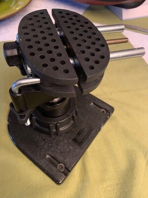

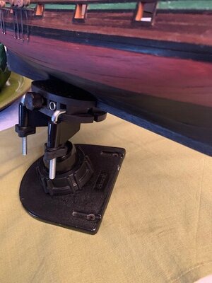

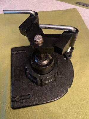

Finally facing the scary task of planking the hull. In my research I saw someone using two metal (?) pieces to hold the planks while planning. Where can I find or make such a tool? can’t tell you how nice it is to have help. Jack
Hi JKB

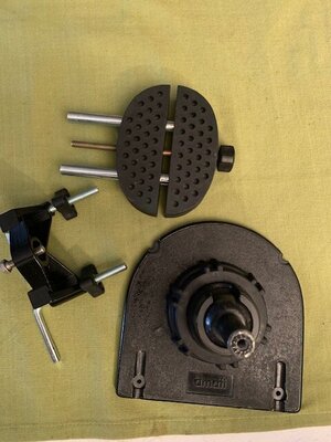

These are parts from Amati which i assembled together and got a very rigid and flexible plank holder for every stage of working.The holder part is hard plastics therefore no damage if you use metal holders.Hope this info is helpfull
Kind Regards from Bosphorus
Good question. I did not find it initially searching for Amati. What I did find was the Mantua version in Cornwall Models in the UK (shipping is easy} (Mantua Strip Clamp - 8155). I also found the Mantua version on Amazon. Mantua Model 8155 Strip Clamp and Hull Vise for Ship Model Building My thinking is that it is not an Amati tool but rather from Mantua. Now, I said to self...get my clamp down from the shelf and see who made it...mine is from Panart (Italy) with the same number, 8155. So go figure...and I don't remember where I got the Panart version...it has been too long ago now.
Thank you so much for your effort. I will look for it.

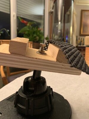

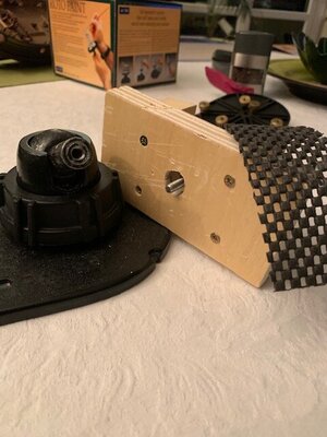

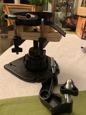

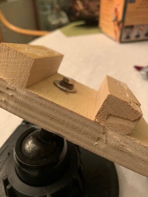

It is difficult to buy only the BallHead Foot of Amati.Normally it is sold together with Amati Keel Clamp or with Amati RotoPaint System.The upper part of RPS is in my opinion a very useless thing. Because of that i bought an Amati Gripper Vice and also the iron made Connection piece separately.But if you cannot find it , so you can make it by yourself using hard wood.I attached fotos how it looks like.I made in 10 min to give you an idea.I recommend ballheadt type foot.
