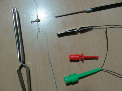

I have also found that small electronic wire leads with clips on end, like other spring loaded tools.
Sometimes you can find them online in electronic supply stores, I just cut the wire off and use the spring hook end which can be small and light weight, but enough to hold tension on a line for the need at hand.

You are realy a wise guy. With your post threaded i remembered that i allready have similar gadgets for my electronic soldering works (see attachment).Because i am no more doing sany oldering work on my hifi devices since a long time i completely have forgotten them.Good idea to use the longer one for rigging. Before getting your post i already ordered 2 pieces by a friend in Washington,who brings them by his next visit to istanbul.I will not cancel the order I think the more tools in the workshop the better ,it does not harm ;) Pirate Flag

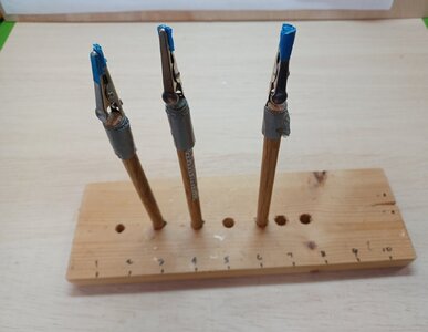

I have used this simple homemade tool to assist in seizing blocks for all my models. All you need is alligator clips, some lengths of dowel, some good old duct tape and a base to mount them in. One clip holds the block with the line wrapped around it, another holds those lines taut and the third holds the loose end of the line you are using to do the wraping, out of the way. I am sure it could be made fancier, but it has served me for years just as you see it!

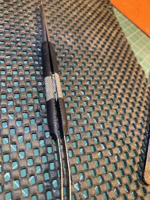

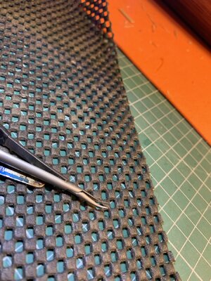

I am using microsurgical needle holder which can be locked
I am using microsurgical needlle holder ehich can be locked ,curved or straight types,
https://www.aliexpress.com/item/100...p_id=20240302121215172952666563600001134870_1
Imho better control for thread guiding with this tool,it is very slim and long enough like a tweezer (attachment).The reason why i want to buy carving spring hook tool (recommended by Corsair from the community)is ,compared with spring hook this lockable type tools or with tweezers ,even if you unlock the tool the yarn stil is attached in the hook so you continue guiding of the yarn without any interruption for example putting the threadend on a belaying pin .

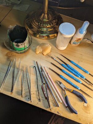

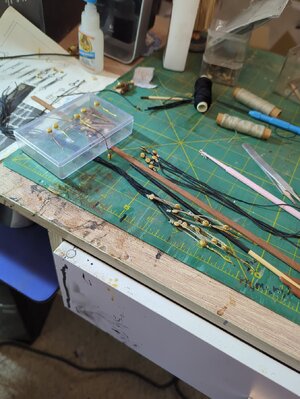

I would put planning at the top of the "tool" list, but I am no pro like a lot of the folks here. I spend some time troubleshooting situations I have created.
I use super glue on string ends and will glue to unusual shapes to get through unusual situations I have created by poor planning, then once I have rigged it through the trouble spot you just cut the stiff super glue bit off. Beeswax and watered-down white glue are very important to me. I do a lot of my knots and tying on the bench, and put pieces up semi-complete. Mecanics wire to make custom tools, and very very good lighting. Tiny drill bits to increase the size or clean up the holes in your dead eyes and blocks etc. I just do them all before I tie them to spars or what have you, having learned the hard way in the past.

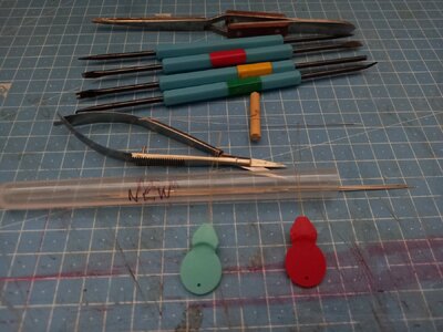

Hi, Hugh: The photo shows some tools that may be unorthodox, but I've used with some success. locking tweezers to hold blocks while finishing them. Plastic dental flossing gizmos for threading blocks. Home-made u-shape for manipulating line - "u" is a needle cut off through the eye and mounted on an old paint brush handle, A small, thin Exacto tweezer - it provides you a "portable free hand " to keep your line tight. Two "spring hooks" of a different sort from Corsair's.rigging_tools.PNG And don't forget a bar of bee's wax (not pictured).
