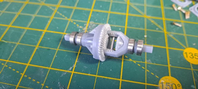

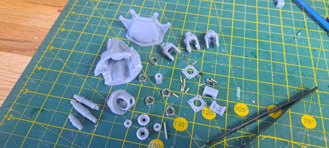

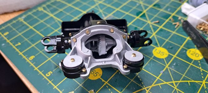

I've achieved another milestone on this project, the differential is done and fonctionnal. It took a few modifications and a bit of fit tweaking but I got it done.
Here are a few pictures and videos

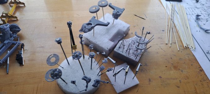

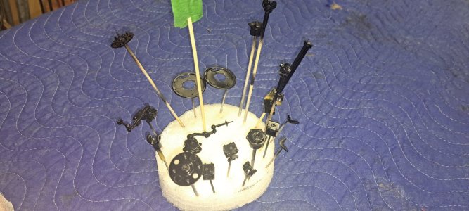

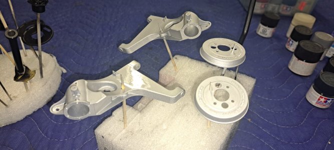

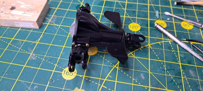

All parts ready for paint

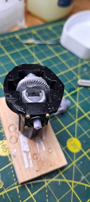

The crown hub assembly

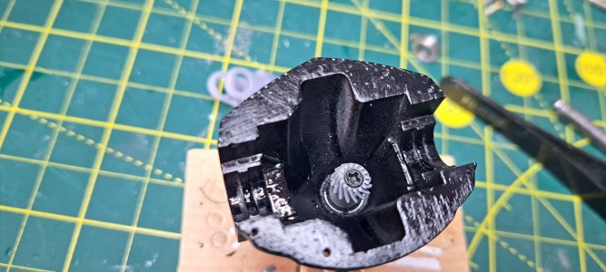

How I installed the 2 satellite gears
View attachment 20260215_151350.mp4

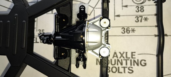

Pinion gear in place

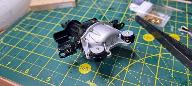

The hub installed

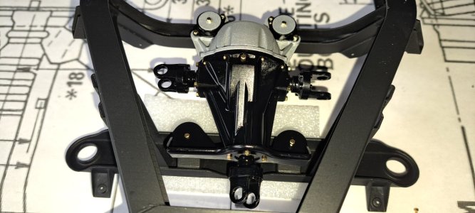

Mounting bracket and universal yokes in place
All done
How it works
View attachment 20260215_173542.mp4

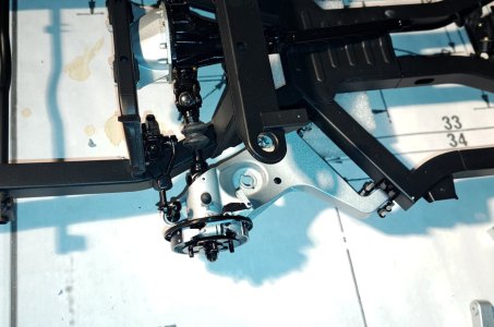

In place on the frame

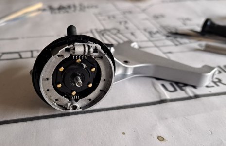

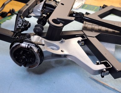

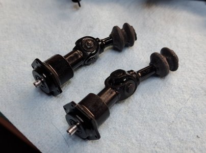

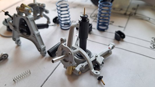

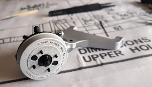

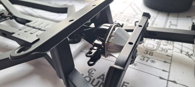

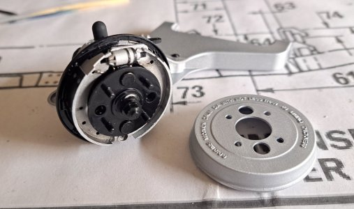

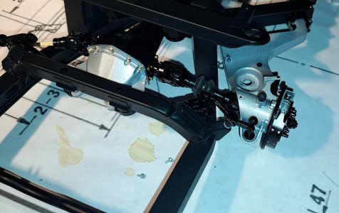

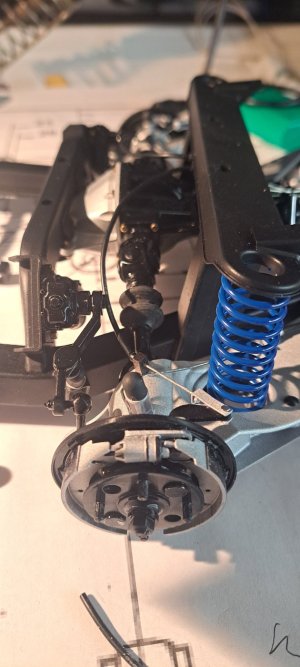

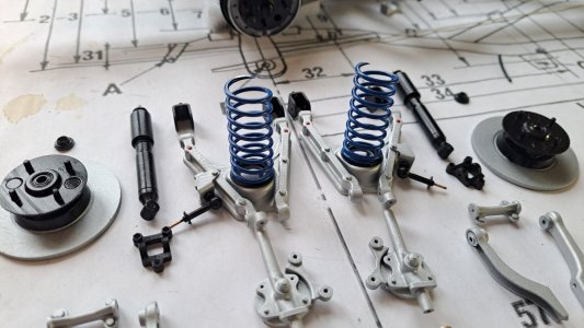

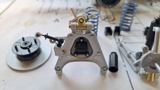

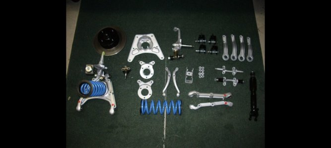

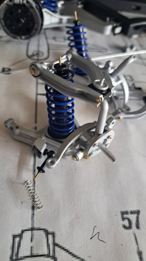

Here are some more pictures of the rear suspension and rear brake assembly. Everything went together nicely but I'll have to modify and reprint the brake drums to given them more with the segments, they drag a little.
The half shafts
The lever dampeners

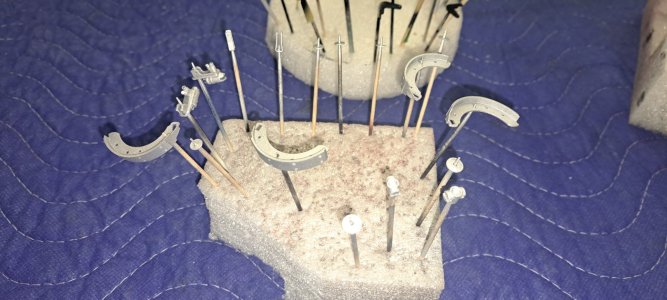

The brake segments, cylinder and extension springs mounted on back plate
Wheel hub added
And with brake drum in place

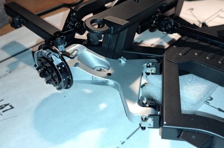

The arm assembly mounted on frame
And in motion

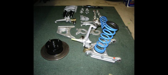

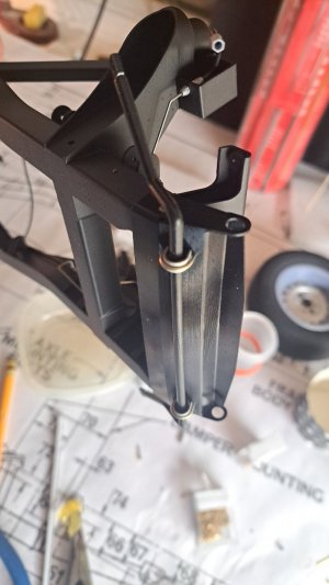

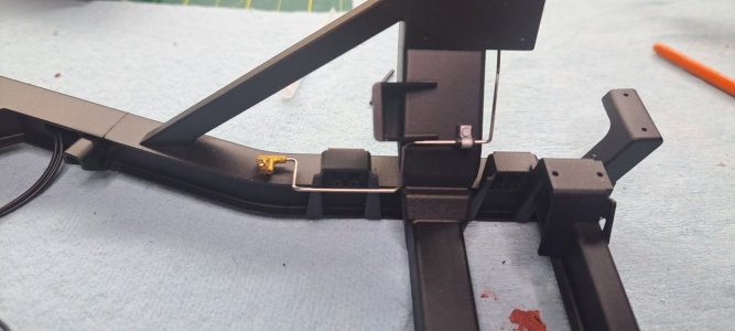

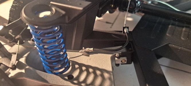

A lot of small details have been done the past few days .

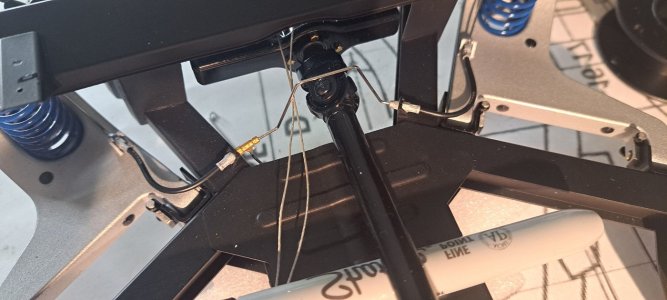

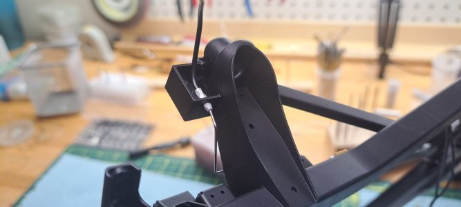

Rear coil springs are painted blue, handbrake cables are installed, rear brakes hydraulic flexible and rigid lines are installed, both front brakes flexible lines and the left side rigid line are done.
Here are some pictures.
Painted coils and handbrake cables
Rear brake lines
Front brake lines
