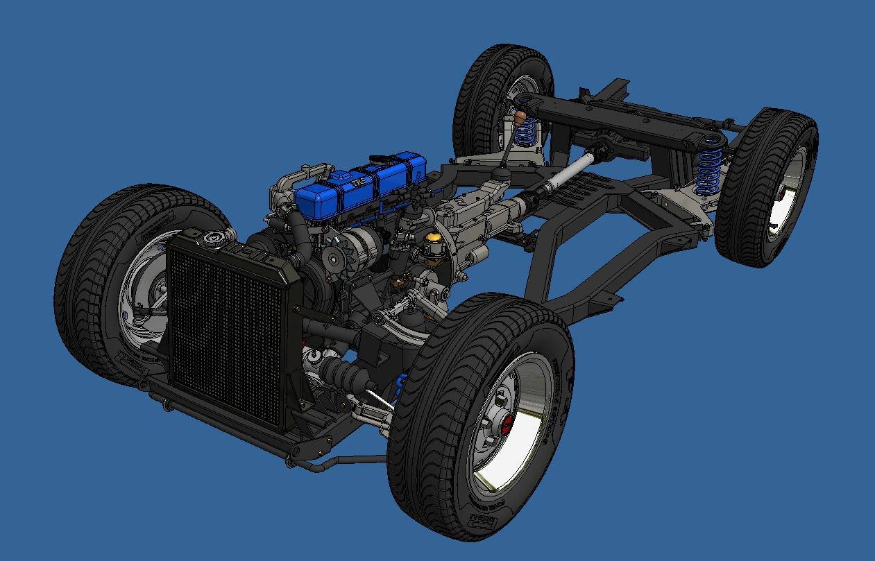

Aside from the carburators, the engine is done. I now have what I like to call a 'digital rolling chassis'. I hope to have a real one soon.
Here are some pictures.

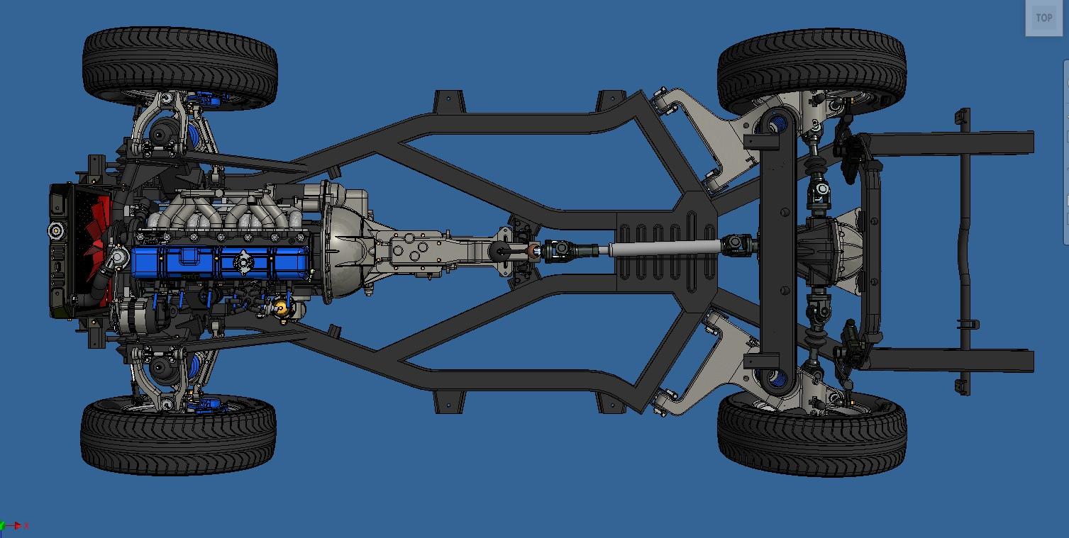

The completed chassis

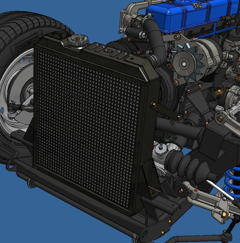

The radiator.

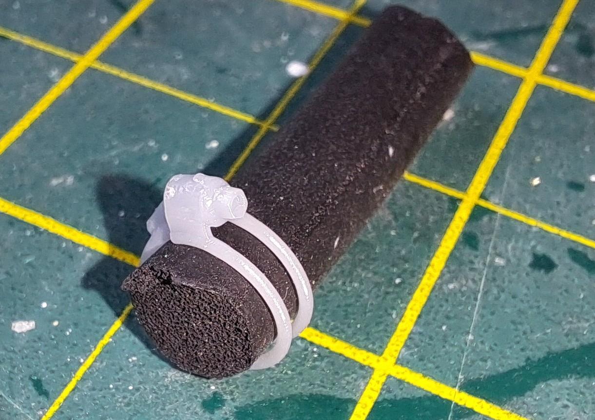

I test printed ones of the hose clamps to make sure it's printable. The 2 wires going around the hose are barely. 020 "in diameter.

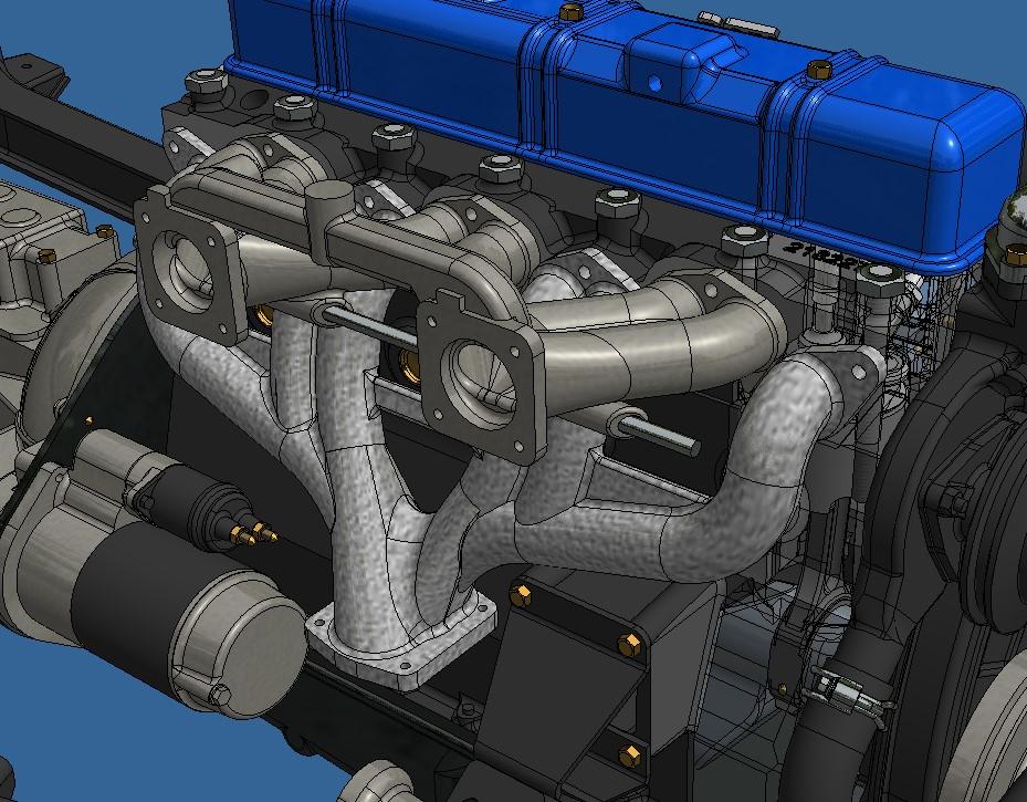

The intake manifold above the exhaust manifold.

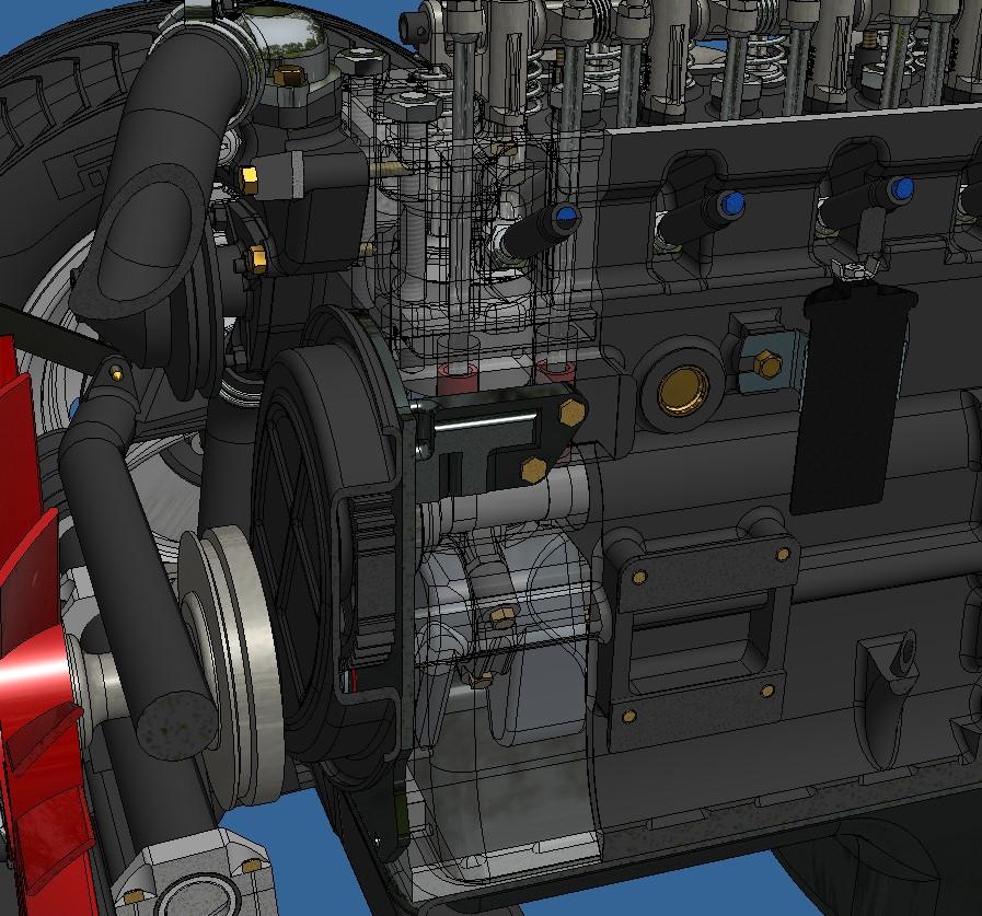

I've taken an idea given to me by Big Messer from the "model car magazine" forum and modified the bloc and head so that the no 1 piston area is transparent. Depending on how translucide the resin is, it might work. I'm even thinking of hiding a pico led in the spark plug to illuminate the area. Really not sure about this last bit.
