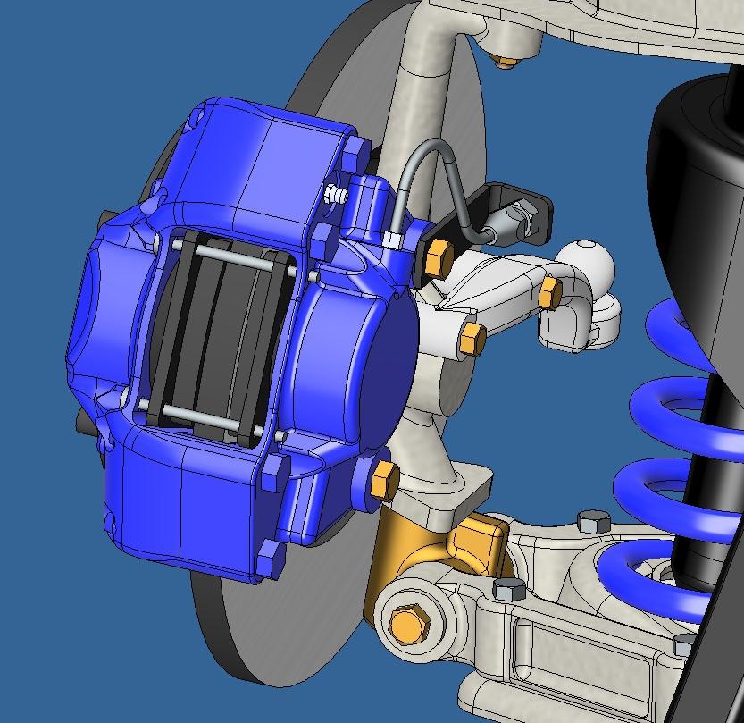

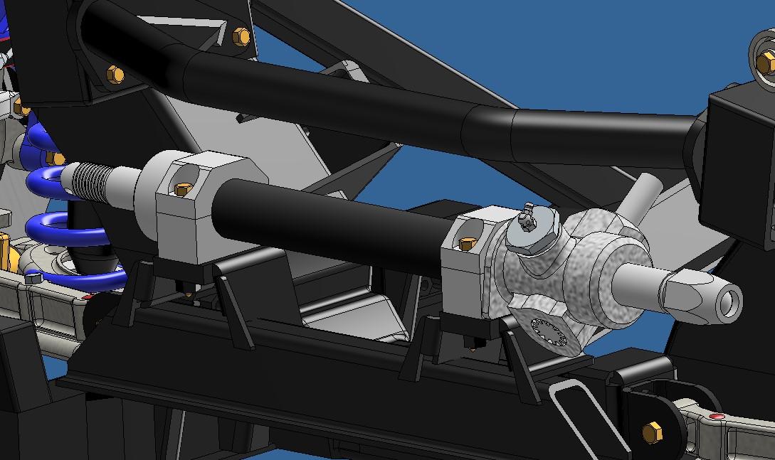

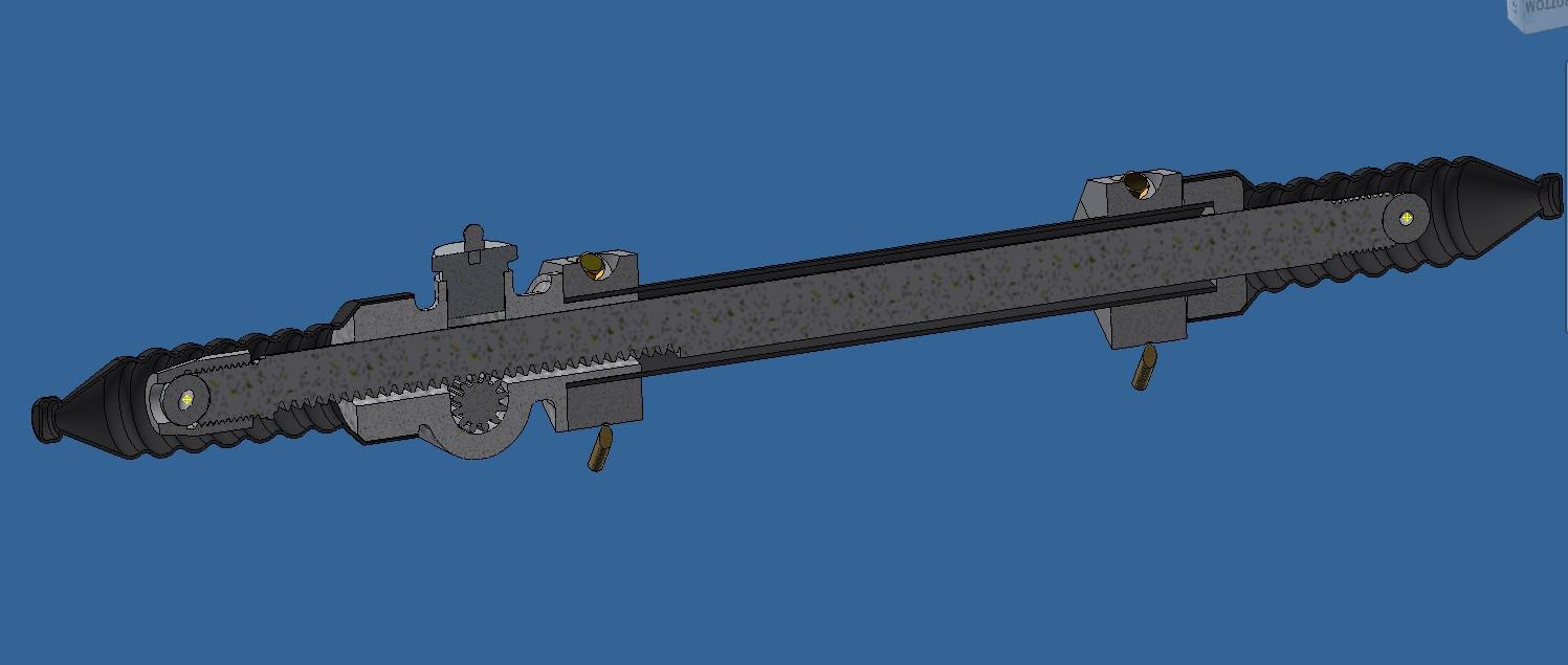

So the calipers are finished. I added the rigid fluid line and the brake pads. I also started the rack and pinion. I'm aiming at a working rack but I've never modeled one before. It will be interesting to see if I can pull it off.

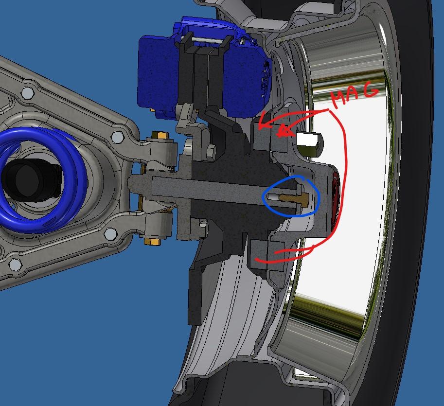

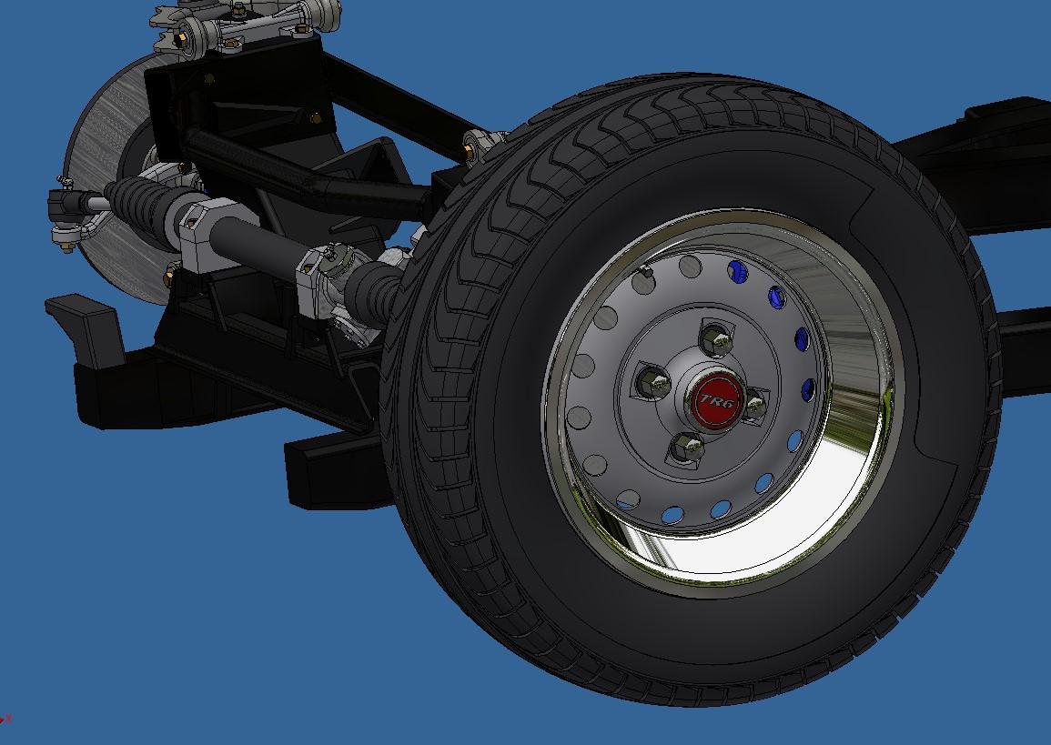

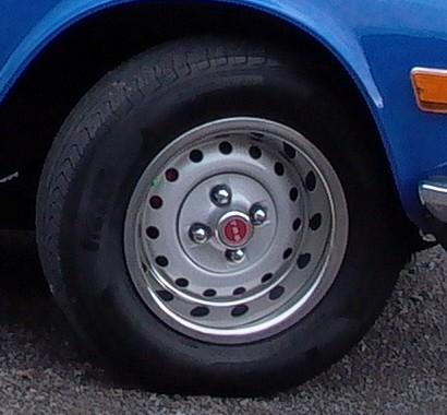

Finished the wheels today and the front axel. I wanted to find an easy way to remove the wheels. My first idea was to do like i did with the Hydra, to use the center cap as a screw. But then I thought of another idea, magnets. I'll inbed 2 magnets in the each hubs and 2 in each wheels. I'll test it before going final with it.
The finished wheel
Vs the real one

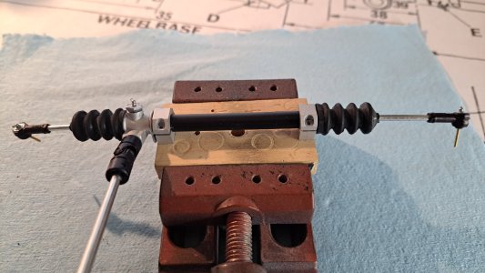

I've been doing some printing test these past few days. I have a working rack and pinion with working rod ends. I still need to refine it here and there but it's close. And I've ordered a miniature steel universal joint (5$ on Temu) to replace the printed ones as it will probably be a weak point in the steering mecanism.
All components in the rack and pinion
And assembled
Working rod end with rubber booth (the boot comes from an RC boat I think)

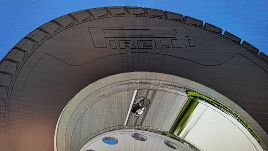

Marquinius, it's all resin. Large tires are hard to print due to the big convex surface. I'm testing with different anti- aliasing settings that should help blurr the ridges. If this doesn't help, I'll have to rely on a bit of sanding before paint. About the tire, it was noted to me that I made a major typo. It's should read Pirelli, not Pirelle. Error fixed, sorry to all Pirelli fans.
Well, I did some printing tests on the tire with a different anti aliasing setting and althought not perfect, it aided a bit. I also reduced the lettering height ftom .01 inc to .005 inc. But I will still need to sand. I did try to sand and paint a test tire. I can see that the end result will be good but since I had very little black rubber paint left and had to thin it a bit (read too much), I will not show you my test (I've have to much pride).
On another front, I have a first sub assembly done, the rack and pinion. Very pleased with the result.

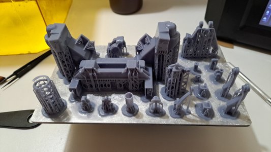

Now before progressing any further with the frame and rear suspension 3d modeling, l will test print the front suspension components to see if everything fits and moves correctly.
Ok, so here's where I'm at.
I test printed the drivers side suspension components along with the from portion of the frame. Everything went together fairly easily, didn't have to make many modifications. I did have to hide a secondary compression spring inside the shock absorber since the printed coil spring is too weak. I'll probably end up using real springs instead of the printed ones. I just need to find the correct size. Remember, this is only a mockup so nothing is sanded or finished. I just wanted to confirm that the geometry was ok.
I also painted a wheel to see what it looks like but again, only a mockup. I didn't paint the ring yet since i'm out of chrome paint. I ordered a new type of chrome paint from Green Stuff, apparently, it's more touch resistant then the revell. I was able to confirm that using 2 magnets to hold the wheel in place is a good idea.

Now, I'm only pointing this out in the most loving of ways and because I know what a stickler you are for details, but, um, "Pirelli" is spelled with an "i" at the end. :cool:
