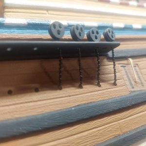

Slow going I need some advice, I'm ready to start mounting deadeyes but need a bit of guidance on what I can use to strop them so I can attach chain to the lower section into the hull, normally I can pinch wire around the round deadeyes but am unsure if they make something for the triangle shaped deadeyes. What have y'all used.
Try as I might, I could not get the proper deadeye rings to pinch correctly, so I used annealed copper wire and tucked them in the holes, it isn't right, but it will do. I may never buy another Trumpter kit again. I'm still trying to figure out how to add some length to the mast while preserving the grain look - WITHOUT replacing them completely. Slow Going
