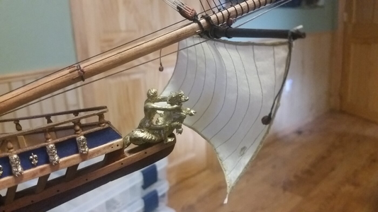

I'm trying to figure out how to tie a block to the bowsprit (or a yardarm). For example, here is an image from @mati.n and his amazing build:
The large triple block will receive the stay. But where are the ends of the rope securing it to the bowsprit hidden? It's not just a large circle (created by a splice) that is slid over the end because stuff is in the way. I'm new to rigging and can't figure out how to make this look right - and there are lots of places I will need to do this sort of thing.

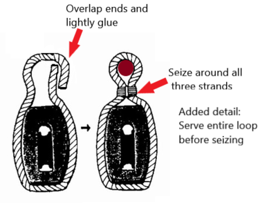

Yes. it was sliced into a continuous loop, then served over, then seized to the block and yard. You have to estimate the length of the closed loop. The first time may take several tries, but with experience, you get it pretty close to the mark every time. If you unravel the ends a bit, intertwine them together, add a bit of glue to hold them, then hide the false splice with the seizing, it looks good. This operation may have to be done around the yard or bowsprit, which makes it more difficult. Use needle nose pliers or tweezers if the work are is tight. As usual, steady hands are necessary, so ground your elbow or wrists on something solid if you can. A shortcut, using and overlapping method, would be this:

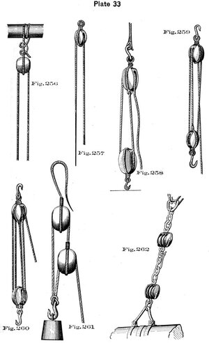

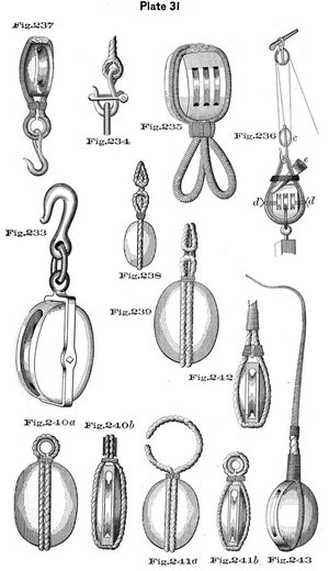

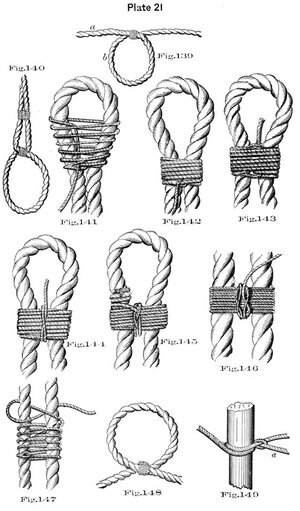

Buon pomeriggio , spero con queste immagine di essere di aiuto

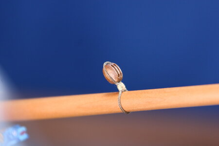

By zooming into @mati.n ‘s picture, it appears the line he has used (even for the large block), is seized, in addition to the seizing hiding the join. Is that what others see?
I would think this would make the binding of the block very much more difficult. Makes you appreciate his work even more!!
PeterG
PeterG
I agree Peter; the rope is definitely served. Matt operates on another level!

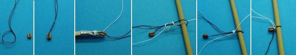

Hello all.
Allow me to add my tip, which it’s an example of what you can do following “my way of seizing”…
What I like most, is that Ι can attach almost anything anywhere, even on already installed rigging.
Thx

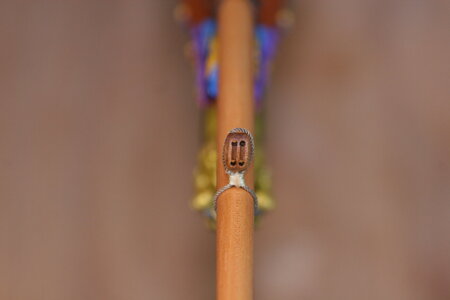

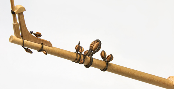

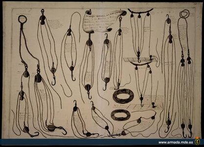

Hi Paul,
I'm sorry to be so late with reply. I'm currently at sea and just simply missed that I was call out by you :p:D
Triple block has stropping served as you see on the photo. This part of the rigging took always quite a lot of brutal force.
My strop itself is made as loop out of piece of served rope. Two ends were simply glued using CA glue.
Then strop received seizing being already on bowsprit. It was a bit challenging because I had to measure how long piece of rope has to be to match diameter of bowsprit and have enough rope to fit block and seizing.
Connecting point of to ends is hidden under seizing ;)
I see that you didn't served you ropes for strops :) If it's not too late I will highly recommend to re-think this decision and perhaps take step back and replace them with served ropes.
Cheers,
Matt
