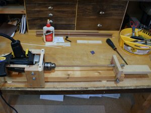

@epicdoom (Joe) thanks for your ingenuity as I have also used bizarre setups. I had at one time what I called my "ugly lathe" as it was a powered drill that ran about 30 RPM --- HA --- try tapering a dowel with that. So, I have been there and done that trying to make do with what I had or have.

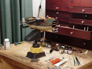

Before SOS forums was born and my very first work bench area a TV stand of which I made long time ago: The tool chest is a jewelry chest that was being deeply discounted from lowes as damaged. The ship is teh Captain Kidd plastic from Lindberg. I was not even doing wood at the time as I was intimidated by it and thought I would or could never do wood. I tried many many years ago and never completed one. I guess this jumped started me again when I got married.
This is my first lathe: My second bench I made out of a solid core door and the little drawers were made by me.
