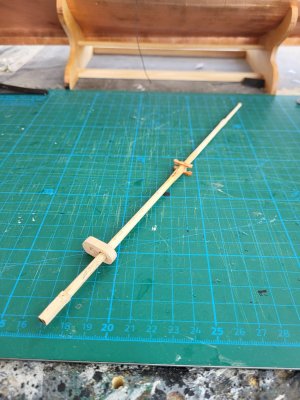

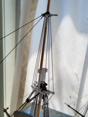

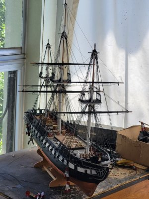

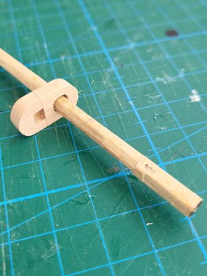

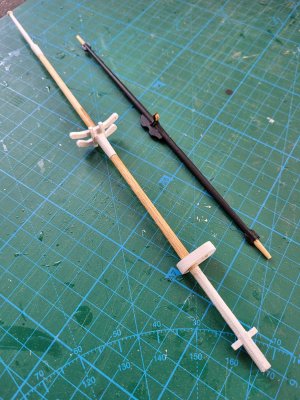

Top gallant studding sail booms added to the group.

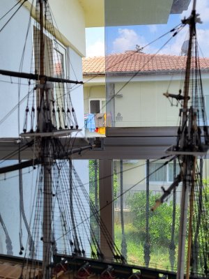

Peter, maybe you already know this, but I’ll point it out anyway. Studding sail booms are mounted on the yards below. That means the topmast boom goes on the main yard, the topgallant boom on the top yard, and the royal boom on the topgallant yard. So it won’t be like in the photo you posted.

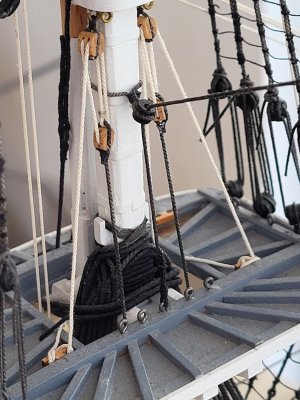

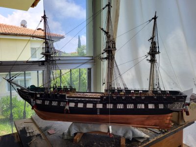

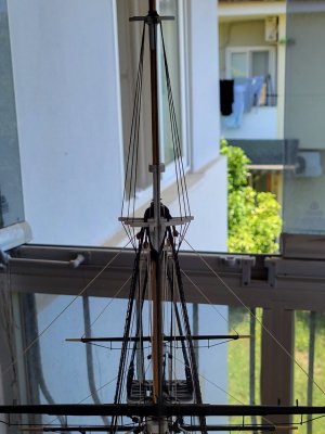

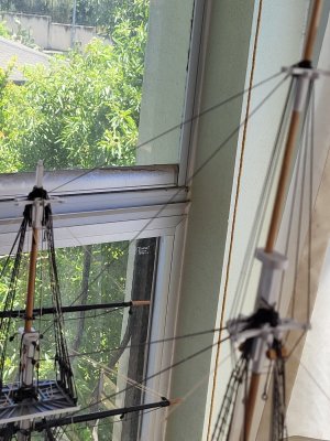

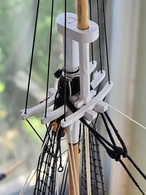

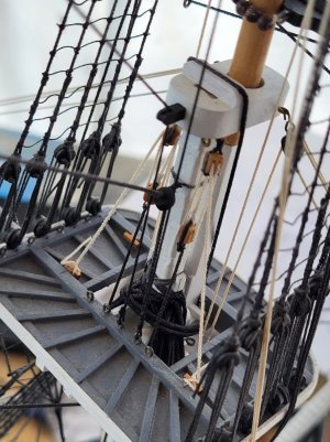

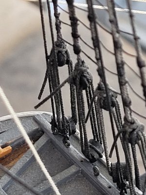

The mizzen topmast stay and preventer stay are now complete. The stay runs through a bullseye already attached near the top of the main mast and is secured to an eyebolt on the main mast fighting top. The preventer stay passes through another bullseye attached to the main mast and is then set up to an eyebolt at the base of the mast using a pair of bullseyes.

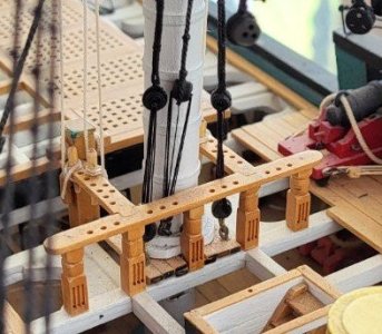

As you can see in the photo, I didn't leave enough space between the fife rail and the main mast, so the central stay connection is slightly off to the side. I'm adding this here so that other friends building this model don't encounter the same problem in the future.

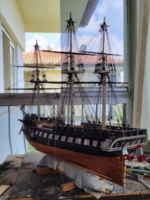

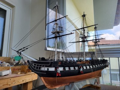

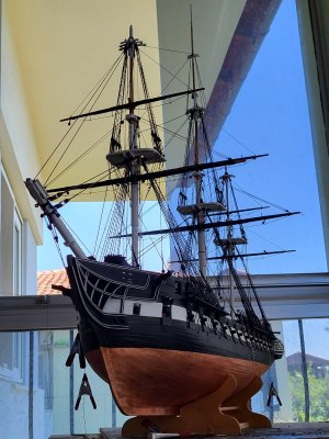

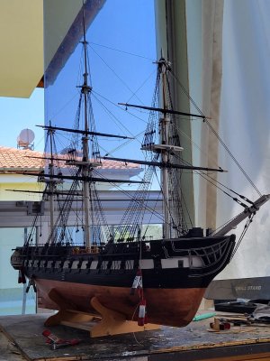

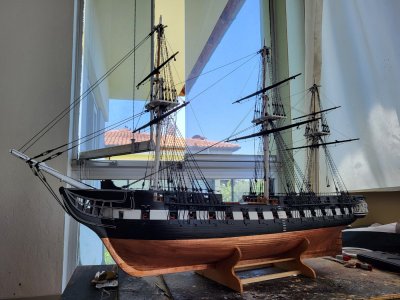

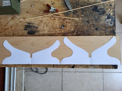

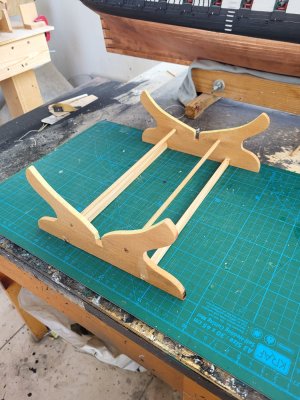

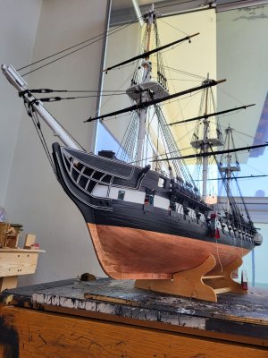

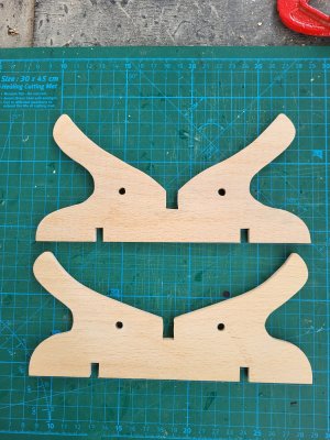

I made a display stand for my model. I chose the area between bulkheads G and M as the support point for the hull. Using the lower sections of bulkheads G and M as templates, I cut the cradle pieces from 6 mm hornbeam wood to fit the hull. I then assembled them using two round dowels and rectangular strips to complete the base structure.

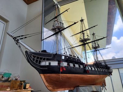

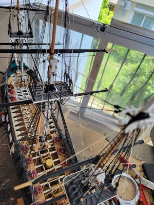

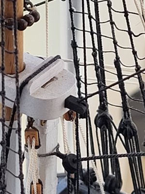

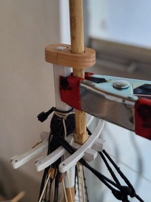

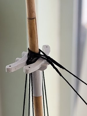

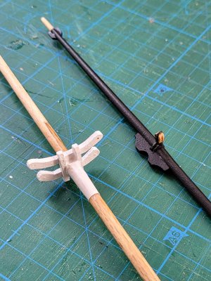

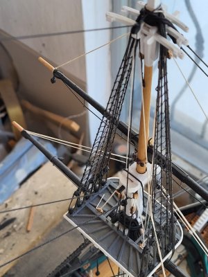

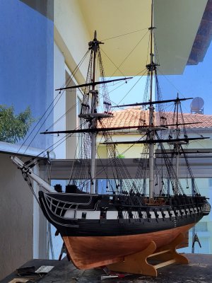

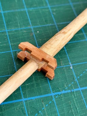

Work has now progressed to the main topgallant/royal mast. The mast assembly and topgallant yard were completed and the topgallant/royal mast was stepped into the cap at the head of the topmast.

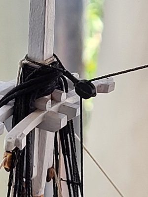

The topgallant shrouds were then set up and secured to the eyebolts previously installed around the fighting top. With the mast properly supported, the topgallant stay and preventer stay were rigged.
The preventer stay was rove through the sheave fitted in the fore mast cap and led down to an eyebolt on the fighting top, where it was set up and secured. The stay itself was rove through a single block seized near the head of the fore topmast and then led to and secured at an eyebolt on the fighting top.
With these elements in place, the topgallant mast is now fully supported and ready for the next stage of rigging.
