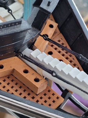

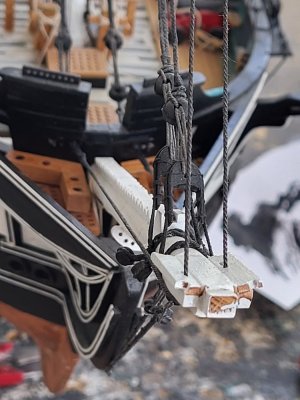

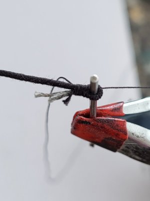

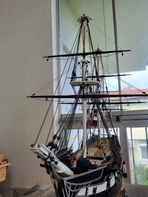

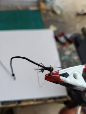

Today I completed the main topmast stay and the fore topmast preventer stay.
It’s important to keep in mind that the stays are wrapped over everything else at the masthead. That means all the other fittings—pendants, shrouds, blocks secured to the masthead, halyards, and so on—must be completed before the stays are put in place.
Fore topmast stay is complete.

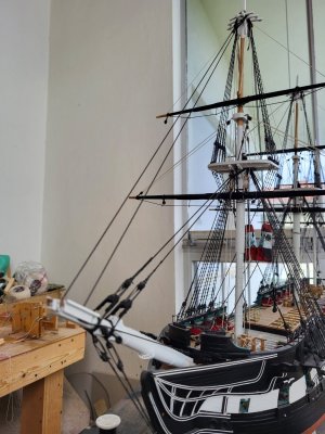

I like how you're working from the inside out - not installing all the spars and then rigging.
Excellent workmanship, as always.
And I'm assuming, based also on my recollection of rigging my Bluenose, that this method is the best to avoid snagging other lines. I attached as many of the blocks to the various spars as I could off the ship. I hope this holds true for the Constitution, as well.
And yes, Mustafa, your Constitution is looking... MAJESTIC!

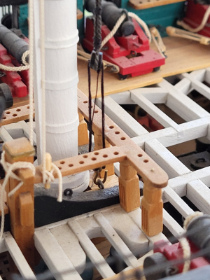

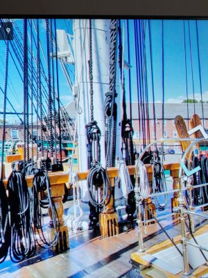

Every time I look at your build, I see something I need to add to my checklist of things to do before installing the masts. Like the eyebolts by the mast in the photo below. That checklist is getting pretty long.
There will be three eyebolts behind the main mast and two behind the fore mast for attaching the mizzen and main stays.
