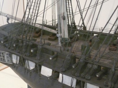

Indeed he did...a bunch. Thanks again Jon. I focused mainly on the ones of the Hull model. We all know that there are some discrepancies and some missing items on this model, which have been attributed to the builders having to hurry up toward the end. Despite there being some missing items, I have always felt that the items that were present on the model must surely have been on the actual ship. With that in mind, the photo below clearly shows that the large cleat directly opposite the Mizzen mast is present

Although not nearly as clear, it also appears that there is one just before the transom

I wasn't really expecting the one at the rear of the ship. There are no cleats either fore or aft of the waist as there is today. Then there is the bow. Although the angles in the photos were not the best, I couldn't really see any evidence of any cleats at all, large or small. Now perhaps the smaller ones were too small a detail to include, as they were rushing to finish, but I would have expected the larger one to be there. I'm inclined to put all of these there, even though they are not on the Hull model. Lastly, regarding the bow. The BJ kit indicates that there is a curved pin rail going across the front of the bow, whereas the Revell kit indicates that there are two pin rails on either side of the bowsprit. Unfortunately, the Hull model does not have any pin rails at all on the entire ship. I suppose since the model was made without sails, they felt this was something they could leave off. What the model does show pretty clearly to me is that the arrangement of the step leading to the bowsprit and the small fo'c'sle that the hammock netting tied into would get in the way of the pin rail if it were going all the way across the bow. So, I think I will go with the pin rails as shown in the Revell model.
Right or wrong, that's the way I'm going to do it. In the words of Collin Raye "that's my story, and I'm stickin' to it"
I originally found the 1812 Isaac Hull Model at the Peabody Essex Museum on the Fine Scale Modeler site. Then I supplemented the collection as I found various images on other sites. (I have a total of 75 images) When I checked the original link to Fine Scale Modeler, all the text was there but the images were not, just placeholders. The text does have a link to an excerpt from Constitution All Sails Up and Flying by Olof A. Eriksen which gives a history of the model. If you have a copy of that book, the text begins on page xxii.

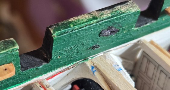

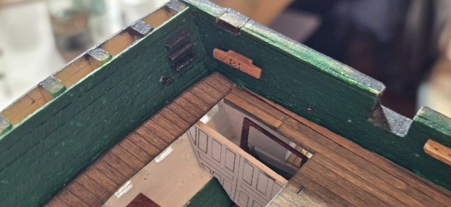

I installed the cleats near the transom and also under the sheave up by the Mizzen mast. I also installed the steps on the transom, which in this period were in the corners not the middle as they are today, and the small iron cleat for the gaff vangs

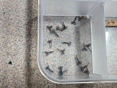

I had thought there was going to be alot more to do to the bulwarks, but apparently for my time period, that's about it. So, it was time to get ready for all the carronades, starting with the eyebolts. As I have mentioned before, I use fish hooks for my bolts. Just cut the eye off using the appropriately sized hooks. Although I don't plan on installing the inhaul tackle, I went ahead and put these eyebolts in place. I drilled the holes for the breech line ring bolts, but these wont be installed now. It is much easier to attach and seize the breech line to the ring bolts and then put them into the bulwarks when the gun is glued to the deck. The last to be done is the double eyebolts for the training tackle. These I made by hand using 28 ga. wire. I tried using Mustafa's method of making two loops at each end of a piece of wire and then folding it in half, but with this tiny wire, I found it more difficult than my original way of looping it around two closely spaced pins

After cutting to size, I heated them up with a torch until red hot, which blackened them

Moving along nicely there Frank. I'm glad that you're two nail double eye bolt bending tool worked well. I tried that and found mustafa's method easier. Lastly, can you tell me what size and brand of fish hooks you're using?

With a slightly larger wire, I could see where his method would be easier. For me, with such a small wire, I could easily pull the circles tight so they are nice and uniform. As for the fish hooks, the brand varies depending on what's available for the size I want, which is typically very small. The larger ones are always available. I buy alot of stuff from Temu. Alot of people on this site use AliExpress, but either way, it's very cheap stuff from China - 100 hooks for $5. If you were rally fishing, you would want good quality hooks, but for what we are doing, these cheap chinese ones are perfect. For us, you want to buy Fly fishing hooks, which are quite small and of course, it's best to buy the ones with a black finish, unless you want the look of brass. Here's a link for the last bunch I bought
As for the size, it depends on what size eyebolt you want. here is a list of approximate wire sizes for small hooks
