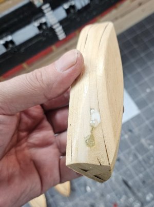

Hi,
Can you help me out here please. just bought the above kit. When assembling the keel together, seems like the dowels they provided in the kit does not fit. What is the dowel size I need or alternative I can use.much appreciated

All I did was cut the dowel out 3/4 inch and sanded down one side and used a jewelers hammer to tap it into the hole and it was a nice tight fit and then I made sure both sides were trimmed and sanded down on each side to build the keel.

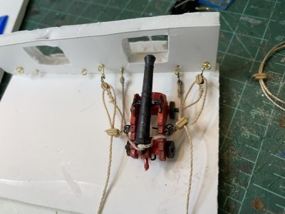

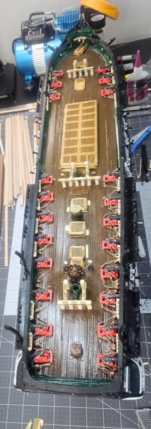

Ok, well I'm finally back after a brief hiatus after my government contract finished and we found out that the company I worked for could no longer recompete because they were considered to big after the DOGE blew through town. Nonetheless, I'm back to continuing on the Conny. I continued where I left off with rigging the carronades which is painful because of how small everything is. It is small to the point that none of the ropes connecting the carronade to the bulkhead fitting are the perfect or correct length making it look taught. But, overall I pleased with it, it still look ok and consistent across the other carronades, lol.20260226_105441.jpg20260226_105437.jpg
I made the rope loops off the boat and then all I had to do was tie the ends to the boat and the sides of the carronades, if that makes any sense. Anyways the idea was to do as much stuff as possible before installing the carronades.

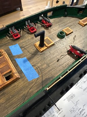

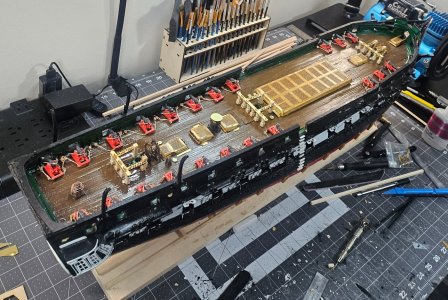

I had intermittently been working on the carronade rigging. Finally yesterday, I decided that the inconsistent length of the side tackles looked sloppy. The breech rope was OK, as I had made all of them slightly long so they wouldn’t looked “stretched”. I was also not happy with the bulwark double attachments for the side tackles, where one tackle from carronade A hooked to the bulwark along with a side tackles from carronade B. I also wasn’t happy with the 3/32” blocks which are metal from Bluejacket - requiring paint which inevitably chips off or clogs the sheave or the stropping hole. I airbrushed them to try to avoid this problem but had to redrill every one of them. Here’s whaat I had just before I decided to rip out the tackles and start over. IMG_3105.jpeg

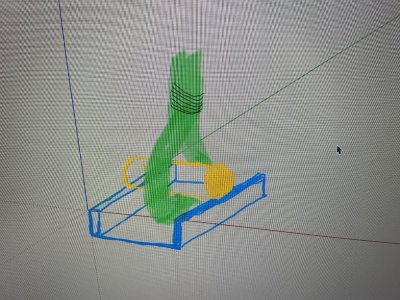

I had been working with a group build of the Gunboat Philadelphia with Olha Batchvarov and we have decided to use Chuck Passaro’s 3D printed blocks which are much more uniform and realistic. Syren Ship Modelers makes 2mm and 2.5 mm pear colored or boxwood colored single and double blocks. I ordered the 2.5 mm (to give myself at least a fighting chance.). I’m leaving the breech rope as they lay nicely and the attachment I made to the bulwarks looks like the original on the ship. My plan is to also use Syren’s plastic 3 mm hook attached to the stropping on the block and tie in the seized tackle rope to the stropping. The hooks with their respective blocks will be installed in the eyebolts and then I will reeve the blocks so that any variance in the length required can be adjusted, so they all lie the same. The attachment of the breech rope to the bulwark is not so visible in the photo, so here is a schematic:IMG_0087.jpeg
The blue is the smallest styrene plastic channel that Evergreen makes and the yellow is a short brass rod CA’d to the plastic. The breech rope wouldn’t fit in the slot so I hardened it with CA and cut out a short segment and basically hooked over the rod to look like it was going around. The back side of the channel piece was then glued to the bulwark in the appropriate place.
I just started doing something similar. For one, the blocks are way too small, but also very difficult to estimate or measure out properly how long they should be, plus the fact the rope goes through the larger block twice. Mine are loose, but uniform enough that it does work as long as they looks the same and it stays consistent across the all carronades.

i hear you. what i did was tighten the loops up once i had them anchored to the ship and the carronades. If I am making any sense.
I have done something similar, I constructed a "set" out of foam board (any kind of scrap will do) with cutouts for the gunports and eyelets places on the wall and deck, as they would be on the ship. I then constructed each cannon with all ropes and coils. After it was finished I simply transferred the whole cannon placement over to the ship glued it into place and attached the lines to the ships eyelets. It gives you much more area to work so you are not clashing into already done work (being clumsy I need the extra space).

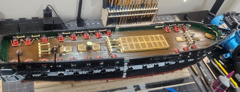

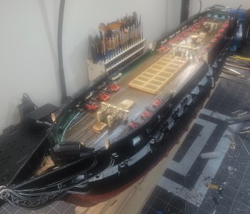

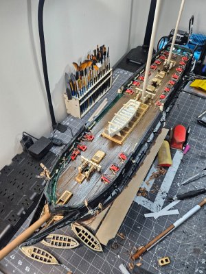

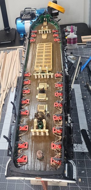

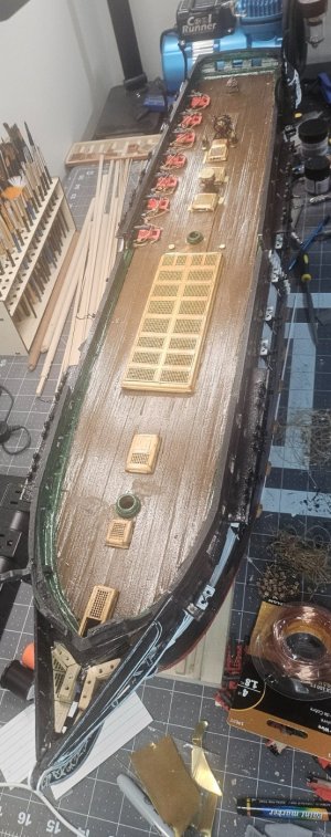

So, I survived the painful rigging of the corronades. I started exploring shortcuts based on what I can or cannot be seen unless you bury yourself into the model, lol. Anyway, I was able to knock out a bunch of stuff and and right now working on the rudder and then the boats before finishing this practicum. Then it's off to the races with rigging and I know I have much better quality rope to work with. The fine rails drove me nuts, especially the forward rails on the ship. I actually broke that twice because I was muscling it around a bit and there is so much already on the deck to break. I have a habit of using one of my hands for leverage while I'm working on something inside of the deck and then I'll hear the dreaded snap, thank God nothing major. Or nothing super couldn't fix, lol. Og course somw of my work is sloppy doing it all by hand, but I have to deal with slightly shakey hands.20260403_140208.jpg20260403_140219.jpg20260405_085325.jpg20260405_085336.jpg20260405_172232.jpg
So, I survived the painful rigging of the corronades. I started exploring shortcuts based on what I can or cannot be seen unless you bury yourself into the model, lol. Anyway, I was able to knock out a bunch of stuff and and right now working on the rudder and then the boats before finishing this practicum. Then it's off to the races with rigging and I know I have much better quality rope to work with. The fine rails drove me nuts, especially the forward rails on the ship. I actually broke that twice because I was muscling it around a bit and there is so much already on the deck to break. I have a habit of using one of my hands for leverage while I'm working on something inside of the deck and then I'll hear the dreaded snap, thank God nothing major. Or nothing super couldn't fix, lol. Og course somw of my work is sloppy doing it all by hand, but I have to deal with slightly shakey hands.View attachment 590178View attachment 590179View attachment 590180View attachment 590181View attachment 590182
it is a lot of work no matter how you look at it. I appreciate cross section models more and more! ;)

I thought I would never get through rigging those #$@&* guns, so I know exactly how you feel. I am about at the same stage as you, but it took me 9 years to get here. I did add a gun deck with all the goodies. At the rate I'm going, you will have long finished before me, so I look forward as how you solve problems as they come up. Well done!

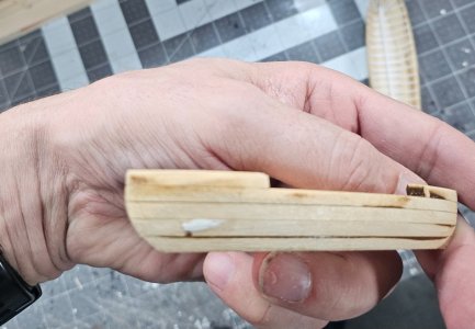

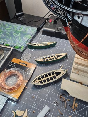

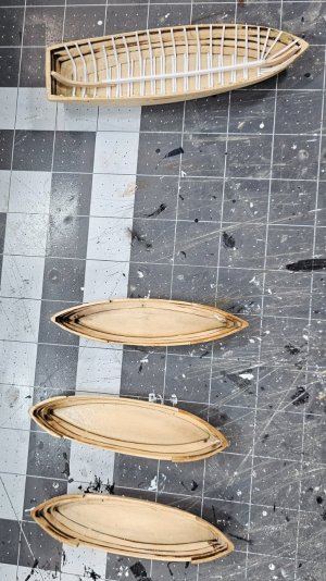

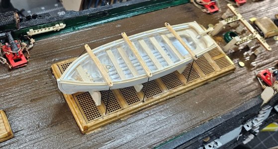

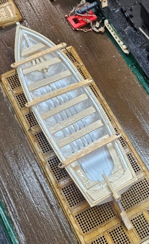

Making it to the finish line with the ship's deck I was getting excited until I realized what a pain the boats would become having underestimated sanding them down and my expectations.20260410_111026.jpg20260410_111020.jpg20260410_111014.jpg20260407_220157.jpg20260407_210438.jpg20260407_210420.jpg20260407_210405.jpg20260407_210355.jpg20260414_105324.jpg20260414_105339.jpg

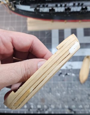

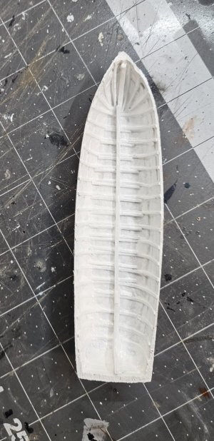

The boats took me about 3 days. I made mistakes along the way because my management expectation was flawed. So, you get laser cut parts and glue them together. Some more burned than others. I was so intent on sanding out the burned areas from the laser that I failed to realize how far that burn goes down and ended patching different areas because I sand it down to far trying to get rid of those spots. I learned that it is ok to have burn lines after sanding because the key is smoothness and not the final look because it will get sealed and painted. Eventually you can see I survived this ordeal, but not without having to refix something along the way.
I filed through the hull of those lifeboats on two of them. It wasn`t so bad to repair as I used wood filler then sanded gently and finally painted. I don`t really like this method of lifeboat construction, but that`s what they gave us...
I would say that I was at it for a couple of weeks, parttime. I am really slow. I am on my second year of construction and am still working on the hull.

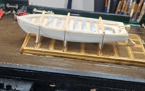

I am now trying to figure out how to attach the lifeboats to the davits. I need more of that dark annealed wire so I ordered some. I also needed to order more cleats. In both cases, I found that the kit did not have enough materials so I had to get some more. Very annoying.
