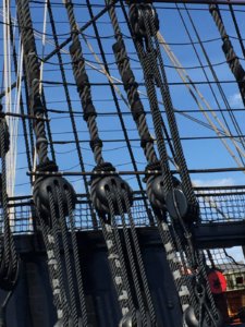

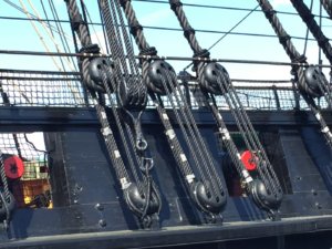

I Then got started on fixing the chain plates and putting in deadeyes. I did realign a few of the chain plates to clean it up a little but decided I'd live with the general unevenness. With them being black I don't think they'll jump out at people too much.
Got the port side finished that makes 42 just 20 to go. I've been cleaning up old knots that hadn't been removed as I go. There are a lot of little details such as the brass eyes that need replaced or cleaned up as well, but I'm moving forward.
Here's a quick update, I've been continuing on cleaning things up as I go such as the eyebolts that have old line tied to them etc. The night befor last I finished installing the deadeyes along the starboard side. 22 years ago I remember I installed the boards the deadeye strops go through before I put in the deadeyes. Because of this I decided to elongate the holes for the strops to get installed. The photo below shows the elongated holes behind the deadeyes.
When I tried to string the deadeyes they were all over the place in terms of not being in line with each other, turning sideways etc. I think these elongated holes were a big part of the reason I couldn't get the shrouds and deadeyes to look descent which is why I gave up on them. So last night I glued a strip of wood behind all of the deadeyes to close up the elongated hole and hold the deadeyes along the edge of the board and in the correct alignment.
I did some touchup painting and will glue the deadeyes to the strops with some diluted white glue and everything should stay lined up nice when I finish rigging it. This is how the deadeyes sit now.

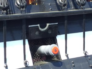

I wanted to do something for rigging on the canons rigging wise, though I wasn't sure exactly what. At 1:93 Scale using blocks was out. Particularly the ones I have they are all way to large. So for a simplified version of rigging canons, I knew I wanted to put in some eyelets for the larger rope. I didn't want the brass eyelets and didn't have blackening solution but I recently came across a post where a guy used this process to make eyelets.
I took a piece of piano wire and bent it into an L shape and put it in a pin vise. Then I took cut a piece of 0.41mm annealed black wire I got from model expo and a pair of pliers, as seen here.
I bent the black wire in half around the music wire and tristed it about 10 times. Sorry about the blurry photo, trying to hold about 4 things with two hands.
And the end result was this. I made 50 of these in about 20 minutes.
I made one out of 0.58mm wire and was able to effectively use the twist in the wire as threads and screw it into a hole I drilled in a piece of wood. It held extremely well without any glue. If you spin the pin vise counter clockwise you would end up with right handed threads.
So my next mission was figuring out how I wanted to rig the canons. I knew working on the deck of the ship would be a pain so I decided to build a rigging jig. Fist I put some paint on the carronade to mark the hole locations.
After getting the Carronade situated, I cut some strips to simulate the bulwarks. I then filed notches for the locations of wires I was using to simulate the rigging. This allowed me to fairly quickly attach the wires to the carronades. I also tied and adjusted the eyelets in holes up against the bulwark initially. once I got it the way I liked it, I pulled the line to the side till it was tight and drilled two more holes. This allowed me to just tie the line tight between the eyelet, back of the barrel and other eyelet and get the correct length instead of fiddling with each line.
The fake bulwark that help it in place for gluing also acted as a jig to cut the wires to the correct length. I used a pair of Xuron rail cutters to cut the wires flush with the bulwark. The rail cutters are a common tool for model railroaders, they're basically just side cutters but they make a really clean cut on the back side of the cutter.
I painted the wire tan and drilled a couple holes in the deck for the eyelets, then glued the carronade on. Here is the finished product. While this doesn't look great by itself in a macro photo it looks much better from 2 feet away and once the belaying pin rails are in place and then particularly when looking through ratlines etc. I think it will convey the feeling of the canons being fully rigged but not totally cluttered up on the deck like it would look with all the oversized blocks. I'm considering adding a little coil of rope on each side of each canon but I'm going to wait till they are all on the ship to decide on that.
It took me a total of about 6 hours to do the canons with this method. Then another hour to put the belaying pin rails back on. Here's a couple quick phone photos of how it turned out. I'm still debating on if I should add some rope coils on the deck. At any rate I'm happy with the look.

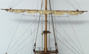

I'm done with the hull and lower masts and now I'm going to work on redoing the yards and upper portions of the mast.
I'm debating on weather to actually attach the yards and upper mast sections before I start on the rigging lines. It'll be a lot more convenient to do the ratlines without the yards and upper mast sections in place. Kind of unsure about the exact order to do this in and of course any way I go about it eventually it will be hard to get to something. One thing I'm sure of is having the blocks in place will make it much easier.
I decided to work on the yards for the foremast today. I took this picture to show what I did 26 years ago. I have no idea why, but instead of gluing strips on like the yard at the very bottom, and as the instructions tell you too. I made the lower yard out of three pieces one larger center piece and used a wire to hold the ends on. Of course it was never quite straight. So today I made the new one at the bottom and cleaned the others up.
After I took this picture I threw the 3 piece one away.

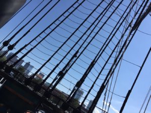

I spent the last couple weeks getting started on the rigging. So far it's going pretty well. I've been just following along with the plans so far, other than prepping every block and eye etc. I could before starting to tie lines.
Here's the stays below the bow sprit.
And the ratlines in progress. They're not perfect but given the complete failure years ago, I'm very happy with how they look.
I completed the lower ratlines last Sunday and haven't really had a chance to do much so far this week. I'm hoping now to finish the upper ratlines this weekend. I'm definitely getting better at using tweezers and tying the lines.
