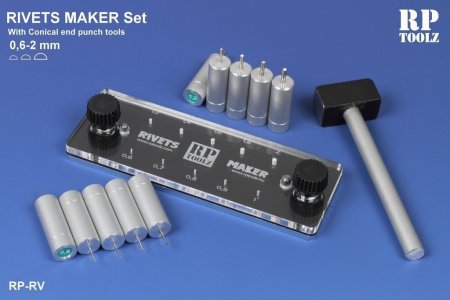

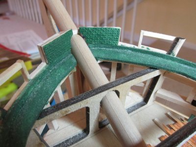

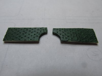

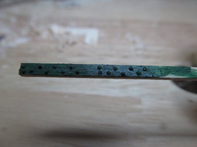

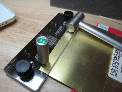

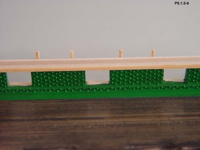

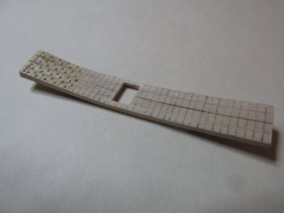

Things were going just ducky, until, when pulling the punch out from the punch plate, the punch handle separated from metal punch. I use some CA glue to fix that. The metal punch, by the way, turned out to be a drill bit turned around. The cutting part of the drill fits into the punch handle. The other end of the drill bit is ground into the shape of the rivet.
This worked, and I was moving along again until catastrophe struck. The punch snapped in two. This time I could not fix it as one half of the drill bit was still glued into the handle with no way to get it out. It broke flush to the face of the handle. I called UMM-USA, the company from which I purchased the tool from, but they didn’t have any spare punches. I emailed RP Toolz, the Hungarian company that made the tool with my story of my experience with the punch, asking how to purchase a replacement.
They responded right away asking for my address to send the replacement part, free of charge I assume as they didn’t ask for any money. Along with my address, my response stated that I expected to break more punches due the delicate nature of the punch, as these drill bits are quite brittle, plus that I was planning on making approximately 2,000 rivets. I again asked, how do I order more due anticipated breakage. Will see how this turns out.

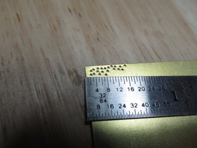

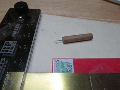

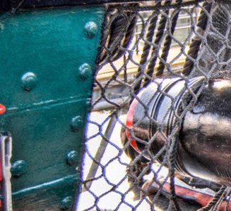

“In the meantime, in between time, ain’t we got fun,” as the old song goes, I made a new punch. Now that I knew the punch proper was a drill bit, all I needed was the right size drill bit and a handle which I made from a dowel. The drill bit was found just by trying different size bits to see if they fit through the punch plate. After I inserted the drill bit into the dowel, I used a fine file to round off the edge of the back end of the drill bit as best I could. It worked! Granted, my punch makes a flatter rivet but that’s fine as I trying to simulate the washer and bolt head on the real ship. Flatter is better.
