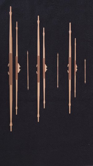

TG yards now turned.
I just took a look at the plans and see I still have a bunch of lathe word ahead of me. Sprit sail yard, studding sail yards, spanker gaff and boom. Jibboom, flying jibboom, studying sail boom, main topmost boom, and I may even turn a new bowsprit.
And here I thought I was close to the end of the fabrication

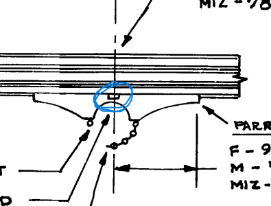

You did a great job on the yards, Peter. I don’t know if you’ll do it later, but there should be an opening in the middle of the parrel saddles so that the tye blocks can be attached to the yards.
It could be a timing issue, Mustafa, but I saw your notes on someone else's build log mentioned that, thanks to you, I am aware of the oversight. Today I addressed that while I was making the rest of the parrel saddles. I don't have time anymore today to upload photos, I still have to wait for the glue to dry on the saddles for the Royals and Topgallants before I mill the slots. When that's done I'll post some pix.
For what it's worth, to those using the Bob Hunt practicum, he doesn't account for these in Chapter 2 of his rigging the Constitution practicum, when he addresses making the parrel saddles. He gets around to mentioning this in chapter 4, page 27, topic 4.2.8 - Topsail Halliard, that there should be "a small hole through the center line where the parrel touches the yard. If you did not put one there when you made the parrel, then simply drill a small hole through the parrel now".

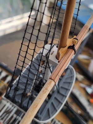

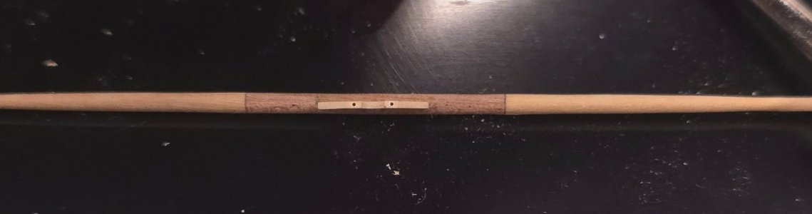

Some small progress made today. Saddles have been attached to the royal and topgallant yards. Sheaves added to the topgallant yards.
I was patting myself on the back for doing a great job of drilling holes into the ends of the main and fore topgallant yards, only to realize I misread the instructions. Turns out that wasn't necessary for those two yards. The four remaining yards are going to be a little bit more difficult to drill into, especially the mizzen royal. There's not much meat on that bone to accommodate a bent eyebolt.
Geez, looking at the photo above, I'm not liking how wide the parrel saddles are on the royals. I may trim them back a little when I return to the shipyard after the holiday.

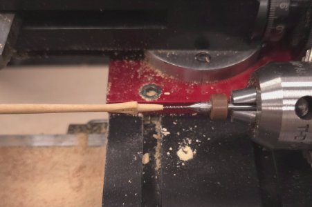

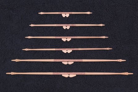

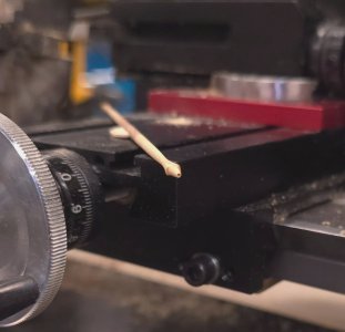

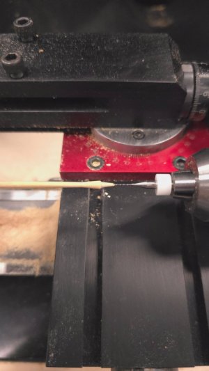

Drilled the holes in the remaining yards. Smallest drill was 0.40mm. I actually had to hand rotate the chuck to get the drill centered and started. The Sherline Lathe has an amazing speed control, and once I was confident I had enough depth, I got the chuck turning at a a snails pace and buried 2/3 of the drill in the yard ends.

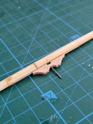

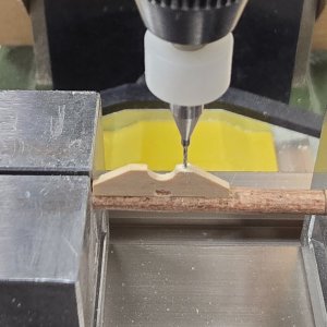

Next up, drill the holes for the eyebolts into the saddles. Also used the 0.40mm drill, as I'm planning to make the eyebolts out of 0.40 diameter brass wire. (The saddles are only 0.80mm thick.)
