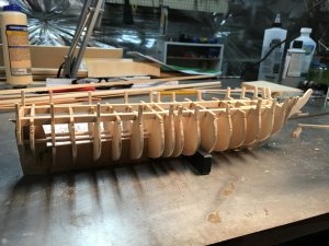

Still researching but managed a few bulkheads for starters.

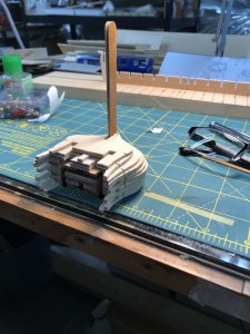

I had to jig the bulkheads in a stack to ensure no movement during glue-up. I did this by positioning the bulkheads in a symmetric top view stack. I then tack glued the edges. After drying I drilled two holes 3.75mm through all bulkheads to accept bracing dowel rods during assembly. I’m pleased with result. It’s straight!
image.jpgimage.jpgimage.jpg​
The build has taken a tragic turn. One sheet of my plans were one scale while the second sheet was off by approx 10%. It could be that the printer service made a mistake or a misfortunate key stroke in Paint Shop. Needless to say the decking is 10% larger than the hull. I know the real reason, lack of patients and attention to detail.
Therefore, this build is scrapped and off to find higher caliber plans for the Constitution.
Regards,
That's a shame but it happens with scratch build, when you have plans made say from a print each plan might be slightly different. I find nothing is exact so adjustments have to be made, that's what scratch building is about. You have to be a bit of a bodger like me. The end result is important. Nobody can see under the wood. Paul
