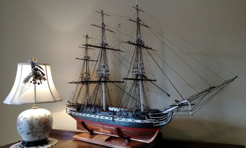

USS Constitution.

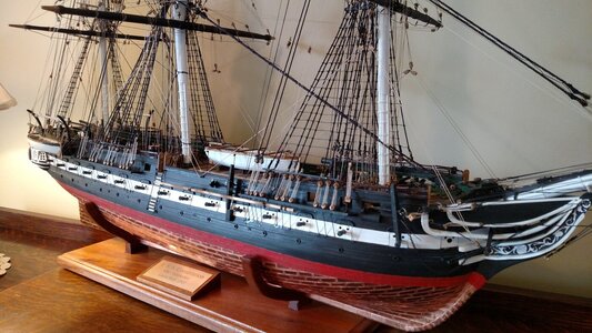

Hi Patrick, I completed this model at the end of 2020. It took me 2 1/2 years to complete and I used Bob's practicum for both the hull and rigging. They were indispensable for me. I see you live in Charlotte NC. I live just outside of Raleigh. If you ever get over this way let me know ahead of time and we can visit. It is a challenging, but rewarding build! I did use copper plates by Caldercraft instead of using the foil tape. Good luck!
Wow! It is a beautiful ship! Thanks for the offer and if I get stuck I may have to take you up on your offer. Mine seem to take longer than normal since I mostly work on them in the fall and winter. I have over 1000 hours on my current build. I usually have 2 going at any given time. As one dries I will move to the other.
