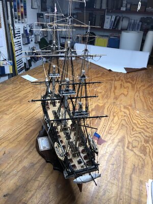

You are completely on the right track. I have just completed the ship. It was a process for me that went on for over two years. I consider myself an average modeler. I do not think I would have ever been able to complete the model without Bob’s practicum. The instruction book with the model is almost useless. I totally agree that this is a very challenging kit but also very satisfying.
Built this kit with all of Bobs CD’s. Great kit. It was my first attempt at ship building. Some of the wood is questionable but useable. Trash the kit supplied rope and thread and go with rope from Syren. Excellent stuff. Be prepared to have a large area for displaying when finished cause she’s a big girl.

I am building the Model Shipways Constitution using Mr. Hunt's practicum as a guide. This is my second build using his instructions (the first was the Rattlesnake) because I could not have made these models without his help. That being said, Mr. Hunt is the first to admit his way may or may not be the best way to do any particular step. Therefore, I study numerous other builder's efforts and follow which ever one(s) I like best in any particular situation. In addition, both the practicum and the kit do not have a gun deck in their model which I wanted. Therefore, I've kit bashed my build to add it. I started this build in 2017 and still have not finished the hull. This is not a beginner's build. The is a lot of detail to consider. It helps to have a large library of images of the ship to look at, which the internet provides as well as US Navy plans which can be downloaded from the Constitution Museum for free. To me, it's the journey, not necessarily the end product. You can follow my progress at either:
