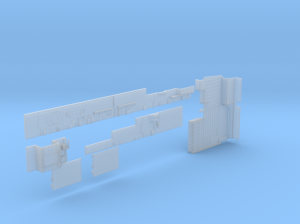

  3. The "Hangar" Details for the Trumpeter is not included and needs after market fitment. Therefore I found all 3 hangars from a 3D printing company: https://www.shapeways.com/designer/gjholmes77. Below are some images of the 3 hangars that he offers.
Why is this important? because when I light the Hangars, some of the aircraft will be visible like the real thing instead of just an "empty room" with bare walls.
