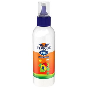

I purchased some Fevicol MR and it seems to be a reasonable glue but didn't think it was special. The part I liked most was the bottle and the means of applying it which is very good.
