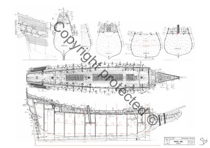

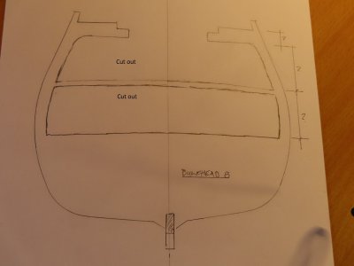

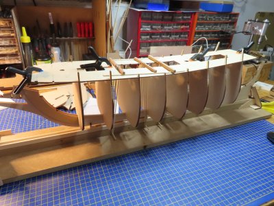

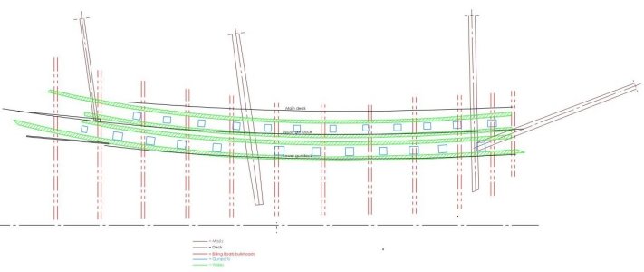

Vasa 1628 skala 1:75. Couldn't hold my horses, got an idea a while ago about adding the gun decks to the Vasa kit. Started the layot in the drawings from Billing Boats, but realised that I have to put the real bulkheads in place and mark the location of the decks on each one of them. I also realize that some of the bulkheads will cover a gunport, but I think that's a problem which can be solved. Biggest problem will probaly be to get the canons in there and make them stay. Now I'm trying to get bulkheads in place, so I can mark them this week and do the drawings next month while I'm in Poland again.

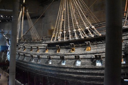

Vasa 1628, Billing Boats Modified: I am now trying to determine the position of the two gun decks. At a first glance they appears to follow a more curved line than the main deck, however this could be an optical illusion, possibly the distance from the bottom edge of the gun port to the top surface of the deck is longer on the rearmost gun ports. My first thought was that it would be the same distance everywhere from the deck up to the bottom edge of the gun port, but that needs to be investigated a little more closely. I get that the distance from the surface of the upper gun deck down to the surface of the lower gun deck is approx. 2.25m (30mm on my model) and maybe a little more between the main deck and the upper gun deck. I also understand that the lower gun ports appear to be larger than the upper ones. I am starting to think that a visit to the museum must take place before I start sawing in the bulkheads.

The run of the gundecks follows the run of the wales on the exterior of the hull, and the gunports are more or less equally spaced above the deck, except for the last port on the lower gundeck. It is in the gunroom, which has a raised deck and the gunport is smaller than the others on the lower gundeck.
You are correct, the lower deck ports are larger (by about 10 cm) than the upper gundeck ports; they anticipate an armament scheme discussed in 1627, of 24-pounders on the lower deck and 12-pounders on the upper gundeck, which was not enacted. So the 24-pounders actually mounted on the upper gundeck were firing through undersized ports, which limited their traverse a little.
If you really want to go all out, the gunports on the port side do not line up with those on the starboard side! They are off by up to a full port width in some locations.

Still struggling a bit with location of the gundecks. I took a few of the pdf drawings that Fred Hocker uploaded to "warshipsvasa.freeforums.net" some 10 years ago, and used them as sketchpictures in SolidWorks. I then tested the drawings from Billing Boats and they fits quite good, both main deck, wales and gunports. Fred mentioned in the forum that these drawings were old and that they were working on a new set of drawings at that time. It looks like Billing might have used these drawings for their model, but if Fred is correct about the run of the gundecks following the run of the wales, then these drawings are for sure not correct. I'll keep on digging for more info

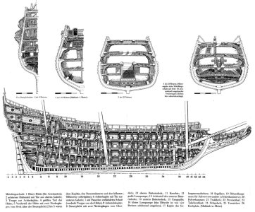

From my recent visit
Hi Frankie
Yes, I have a few pictures myself like this from av visit back in 2008. But my problem started with the drawings I found on the Internet, uploaded to a forum by Fred Hocker. According to what he states here in this thread, the curve of the gundecks pretty much follows the curve of the outside wales. In the drawings they looks differerent, but I have decided now to let them follow the wales, and to have the same measurement up to the gunports all over each deck. It might be so that the crossection in the drawing shows the center of the deck and when the deck is getting narrower the further aft you go, this may be the cause of this optical illusion. A closer look at another drawing seems to verify this.

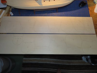

So, finally back in Sweden after 11 years going back forth to Poland. I'll keep on working a few years more, but only a few days a week, and from home. Took me a month to arrange my office and "shipyard" as I want them, but now I feel like proceeding with my projects. When it comes to Vasa nothing much has been done since last, just finished some drawing and draw up the outer lines on the bulkheads on the newly bought faneer. A small step forward, but as I'm still working on the Norske Løve, its' gonna take some time for sure.

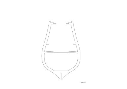

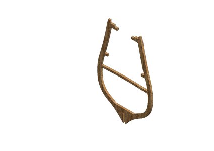

Back again with my Vasa project, it has been put on hold for a number of reasons. After a lot of thinking back and forth I decided to draw the frames up in my cad program and actually create a 3d model with the keel, stem, stern and bulkheads put together to verify that the gundecks are located correctly.
